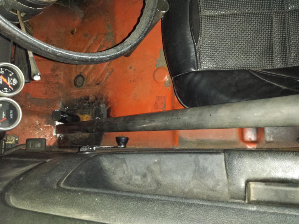

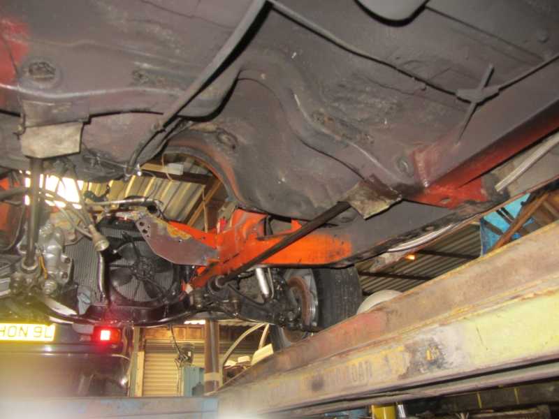

A quick shot of the underside and the chassis connectors.....
Challenger underside.jpg (56.86 KiB) Viewed 1595 times

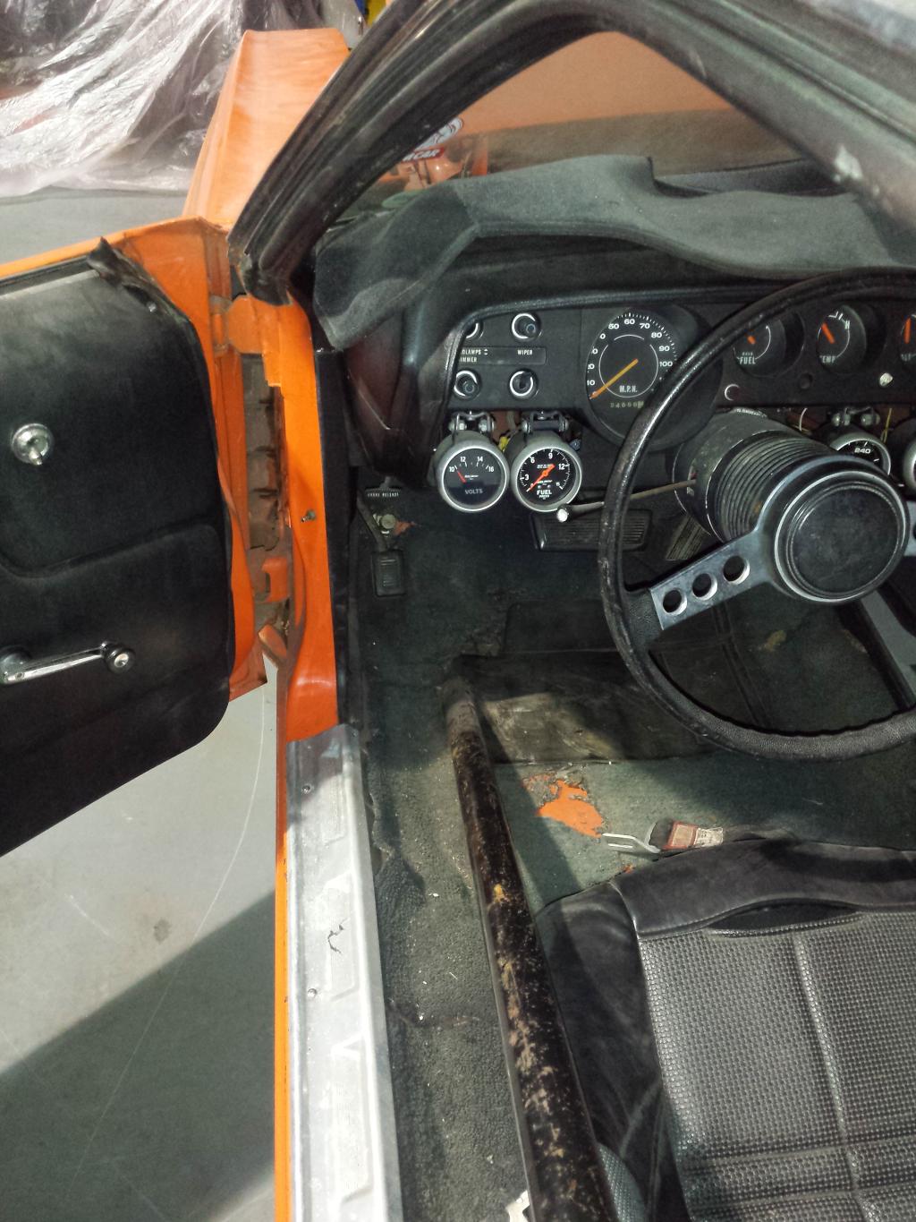

As mentioned, Pete at Chassis Tech Race Cars made a bit of a start (Don't panic, Jon!!) on the cage and hit a couple of issues - not helped by my size 12 feet!!!
The Original fixed door bars were relatively in-board, a fist look indicated that these could be moved further out for more room and still door handle clearance.
Finished ones will be swing out style; more cost but easier to live with....
Challenger original Door bar position.jpg (179.86 KiB) Viewed 1585 times
Here is one option for the door bar:
Challenger revised Door bar position - 1.jpg (109.85 KiB) Viewed 1582 times

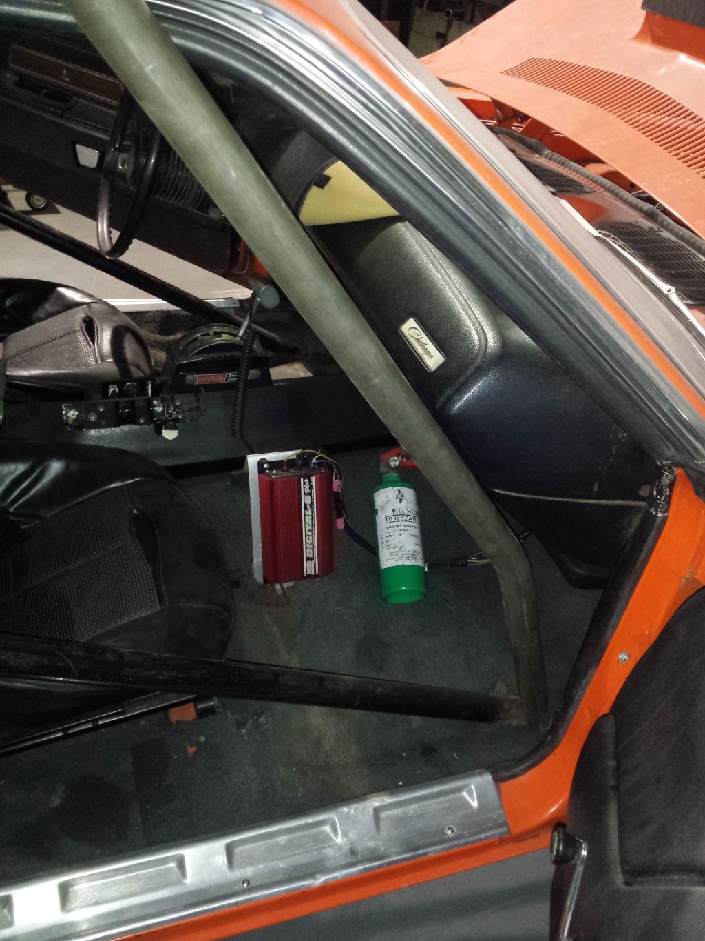

Unfortunately, if this were adopted together with a revised cage with an "A" Post and chassis ties, the Post will fall well within the passenger compartment and not offer sufficient protection to the legs....
Challenger issues with A post cage.jpg (167.38 KiB) Viewed 1579 times
This can be seen more clearly on the Driver's side.....
Challenger Door bar and A post issues.jpg (117.47 KiB) Viewed 1576 times
Looks like the Dash is coming out (sorry Pete........... :oops: )
