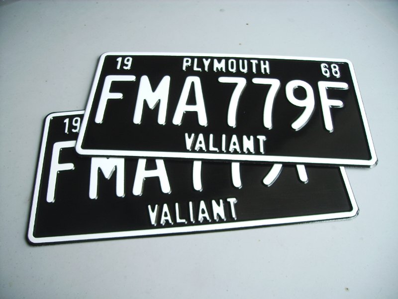

my new black and white number plates arrived from states plates but...... i really like the ones i made for it so may just shelve the new ones for now. at least i won't need to buy one if i fit a towbar to the car and want to drag a trailer/caravan about.

Like those plates...

Re: 68 valiant signet 2 door
which ones mate? the new ones or the ones i made?
Classic plates... not a fan of carbon fiber sticky stuff.
i only used it as i had it. now they're fitted you have to get up close to see the carbon 'look', otherwise it's just black
