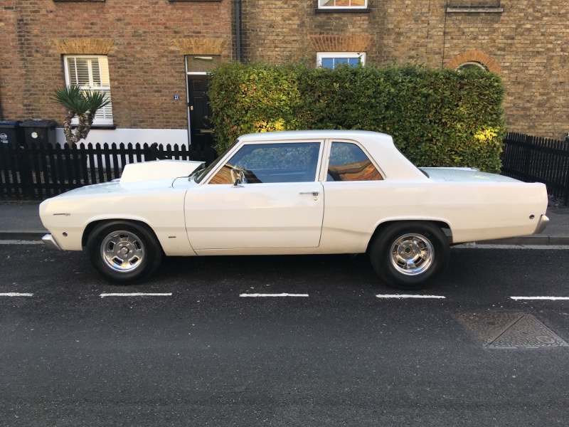

First proper run out Today, all went well until it started to flood just as I got back to the workshop, should be an easy fix.
Posts: 7516
Re: Blue's Valiant
Well done mate, good to see it out and being used. :thumbright:

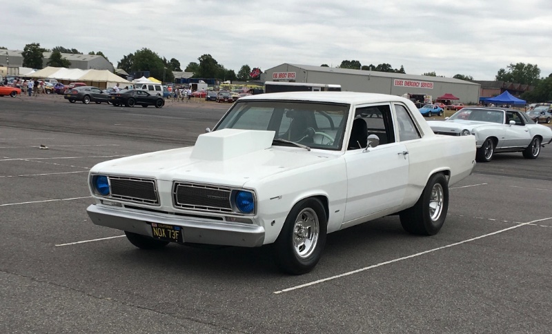

First proper clean in 5 years of ownership,I actually polished it! looking forward to Brooklands Tomorrow.
Posts: 7516
Re: Blue's Valiant
Have you cleaned it just for the show and shiners tomorrow
Posts: 14459
Re: Blue's Valiant
No I just didn't want to show the rest of you boys up!

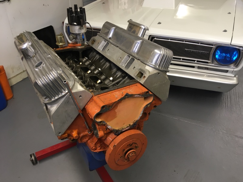

Looks like the 408 is moving further up the to do list, might start by porting the heads while I try and get some money together :roll:

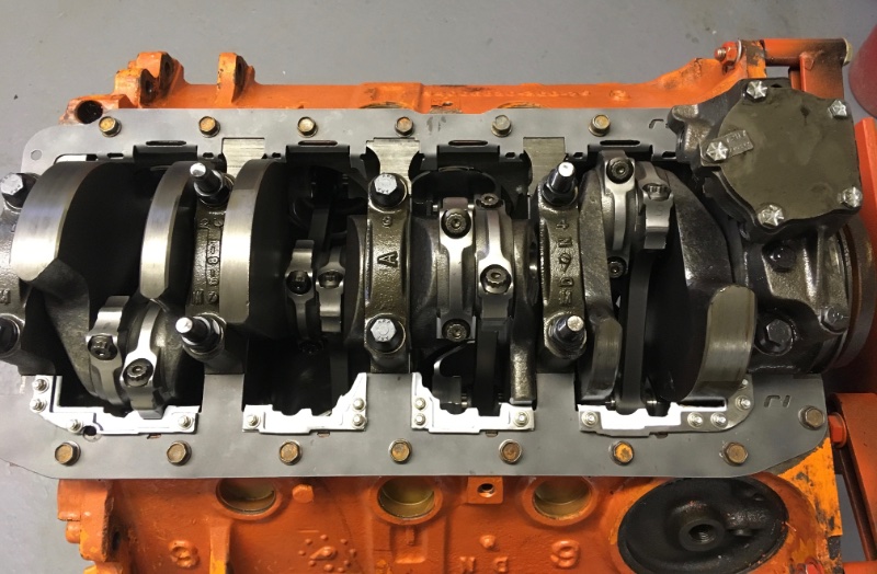

Re: Blue's Valiant
Fitted the crank scraper today. This is a hand made one from Ishihara & Johnson, you have to custom fit it to your particular engine which takes a few hours. The white teflon actually just touches and wears to the correct clearance. They make some proper mad stuff, have a look at crankscrapers.com.
