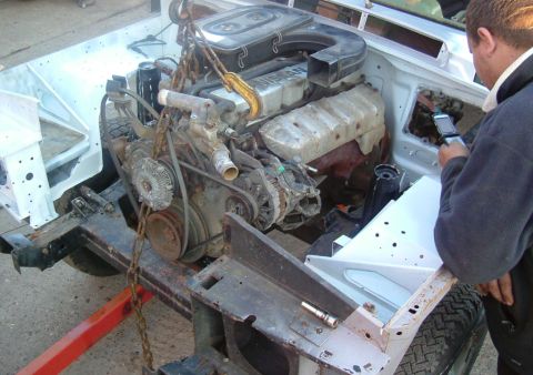

Plans for this one are to make a hybrid vehicle using Rangie Chassis and body, and Nissan Patrol engine/transfer, props, and axles/brakes/wheels,instruments and seats.

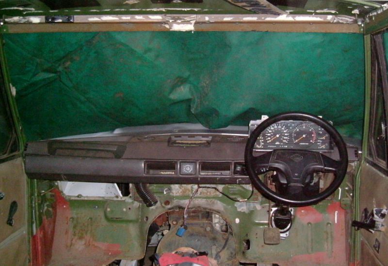

Hi thanks for the offer but my engine is 4.2 diesel. and ,my Rangie is a 1972 , (and I will probably be customising the whole electrical system or just making my own loom ) so I don't think it will help.
I need to use the Patrol instruments as it has electronic speedo , and a tacho too.

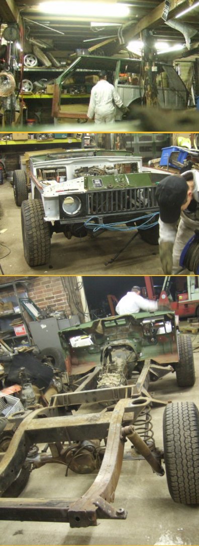

started on the Range-Trol
Lots of modding and fabs
Let's just say.. i'm glad I bought a plasma cutter!

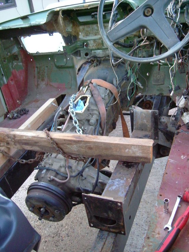

its getting more and more dismantled at the moment, love the way the shells unbolt from the bulkhead and floors, check it out. 2 people can carry the main shell.

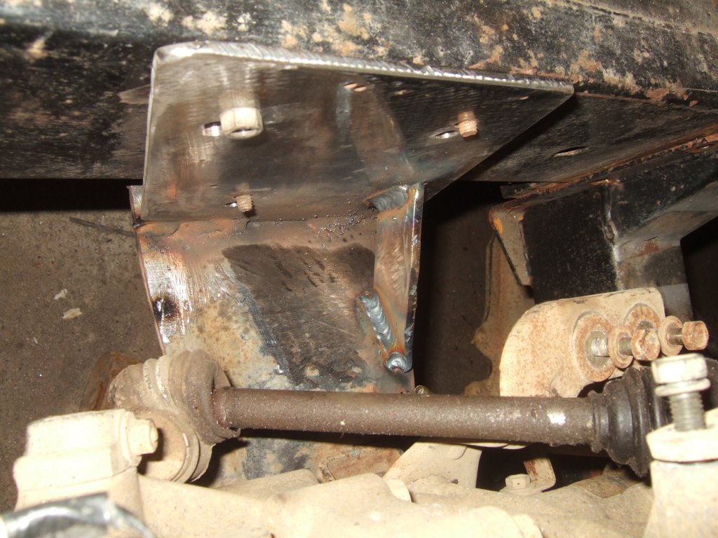

zzzzz makin brackets
to mount the transfer case.
job jobbed
