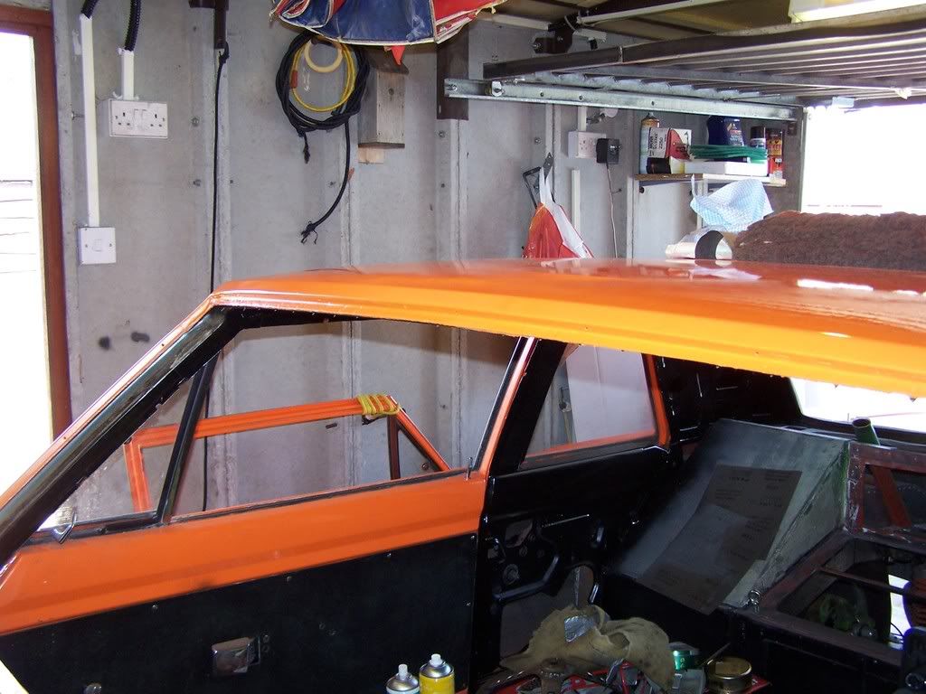

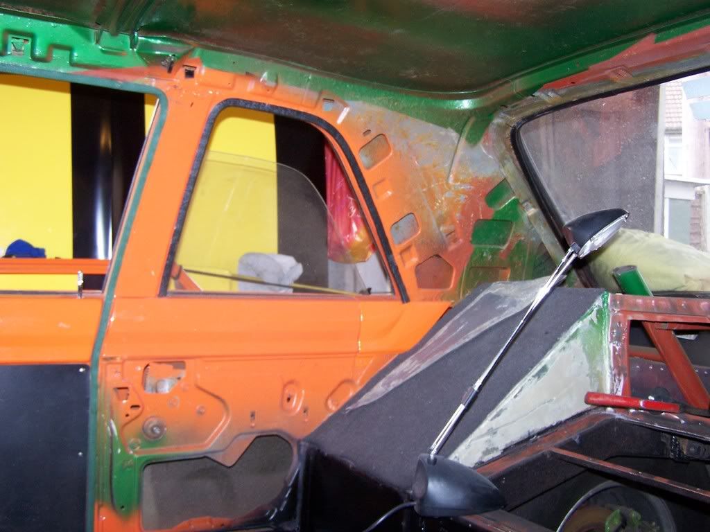

When I bought the car of John I knew that I was going to have to replace the roll cage at some stage. But I had planned to do that after I got the car running, it wasn’t until the Dart had been dropped off at mine that I sat in the car for the first time and realized that when I adjusted the seat to my liking my head was touching the main hoop, not a problem move my seat forward I thought, no as I leant forward my head pumped into the front hoop and my legs were now hard against the brace under the dash. So the cage was going to have to be removed before the car hit the street among a lot of other things. So I rang Hauser’s to provisionally book the car in for a new cage to be fitted and was told it would be at least a couple of months and that it would be a lot cheaper to remove the old cage myself, made sense. So that weekend I went into the garage to start chopping the old one out, but first I had to rip out some of the paneling that was in way easier said than done, when John had put it in he didn’t intend it to be removed, well I had a big hammer and it came out. After four days and very sore knees the paneling and cage was out. It was then I started to look at the rest of what was left of the interior mmm it didn’t look good so many different colours, I may as well paint that while I am waiting for the cage to be done.

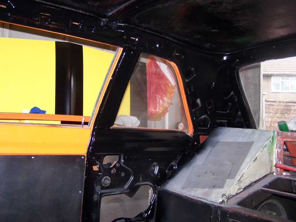

It’s not the prettiest of jobs I know but I never intended this to be a show car it just had to look reasonable from 20 feet. I have not painted the inside of the doors yet as they are coming off as the hinge pins are shot on both sides.

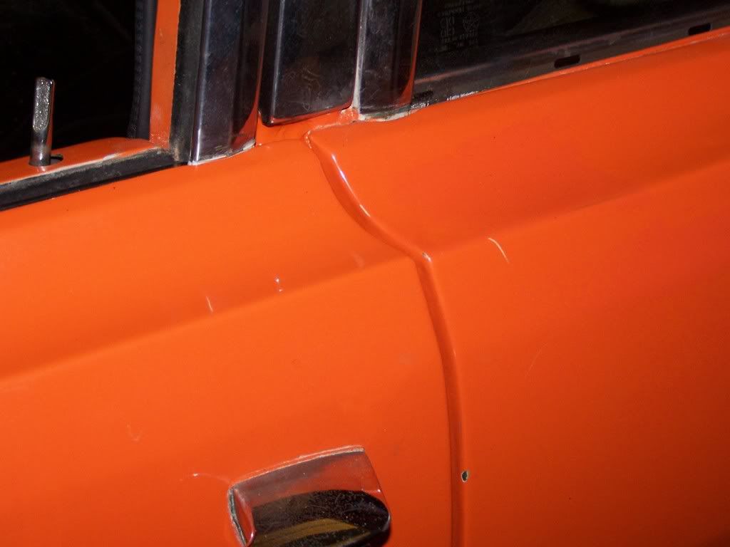

This is when I found out that the front glass is different on a 2 door sedan to a hardtop so the search was on to find a new screen when Blue suggested that it may be the same as a four door valiant and that Kev may have a spare, he had so job a good un. I also managed to find a screen rubber on ebag. Unfortunately as the rubber was removed from the hole it pulled all the paint off, so I have had to rub it down and prepare the area for paint. As with the rest of the car I found zero rust in this area.
Not too bad a job even for me and under the florescent lights in the garage I cant see the join although it may look bad in the photo.

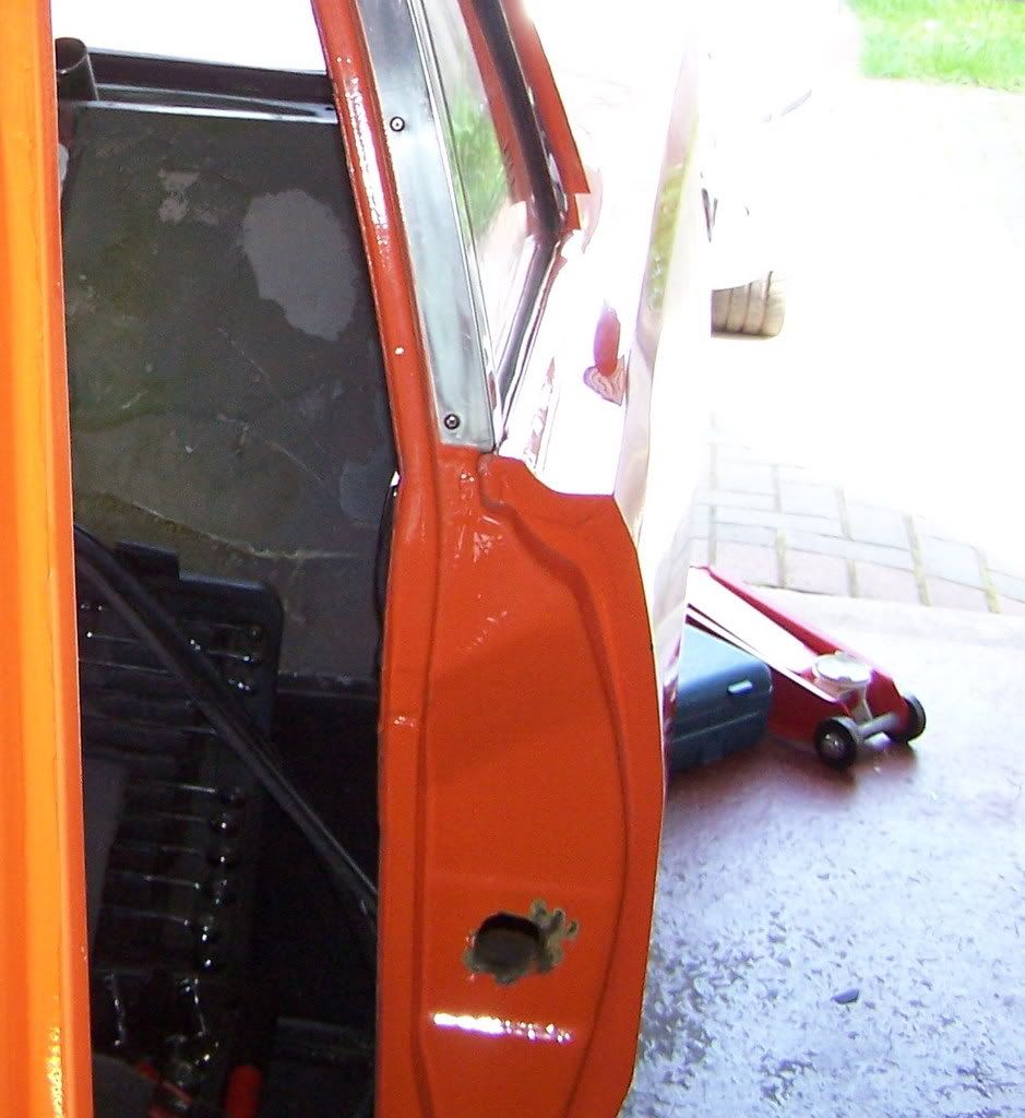

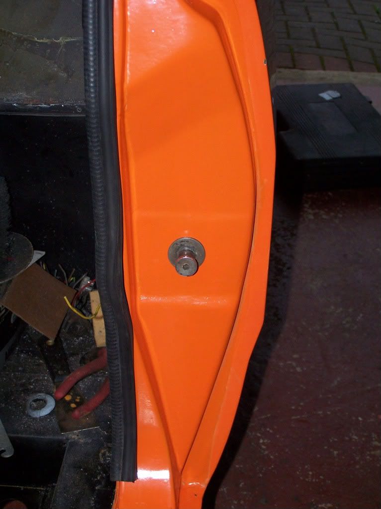

The next job was to tackle the damaged door striker this had been damaged due to the hinge pins having nearly worn through
A repair plate was made and welded into place a bit of snot a it looks as good as new
Even the door lines up with the hinge pins fitted :shock:

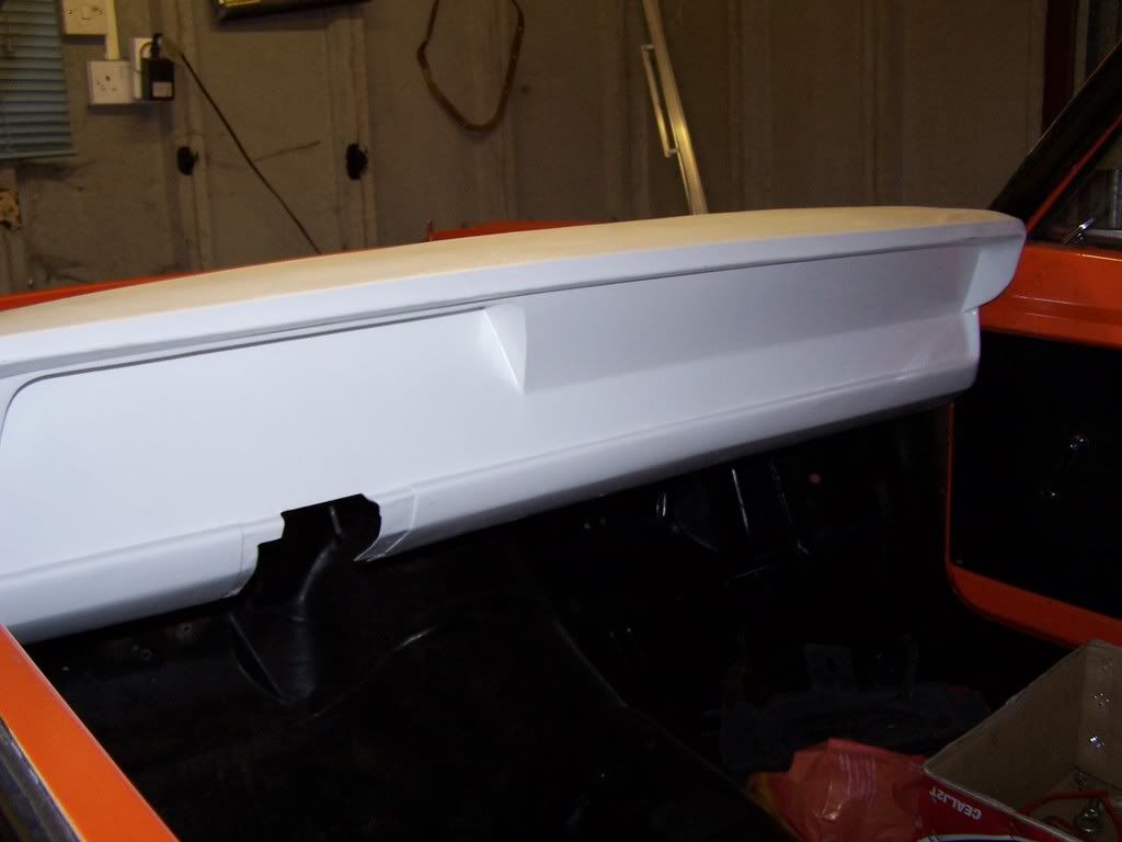

New lightweight dash from DRE had it trial fitting

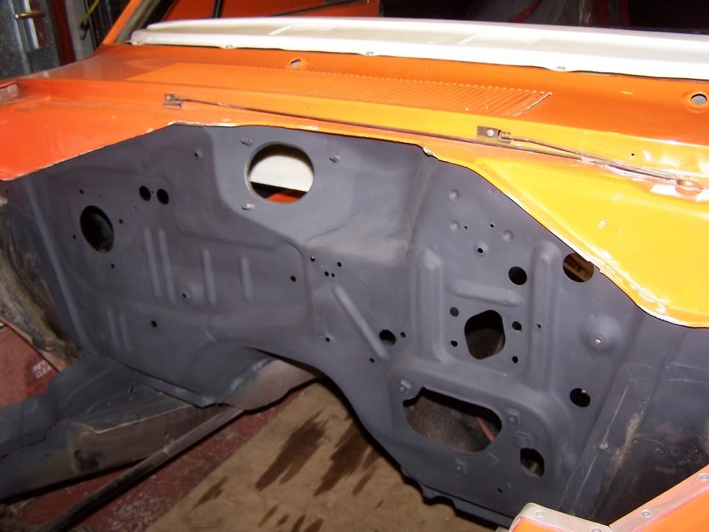

I also took the opportunity to clean up the bulk head as all the paint had started to flake of in places due to the fenderwell headers; I used a twisted wire brush on the angle grinder to get back to bare metal and welded up the hole for the old bulkhead connector then repainted in heat proof paint. I not to sure on the colour though. I may go back and weld up some of the unused holes and repaint again? :?

pete walton wrote:Guy looking good mate , did you get the dash from Dale??? and do you have to remove the windscreen to get it in .Its a job i have planned far the winter so any tips would be nice :thumbright: :thumbright:
yes Pete I got the dash from Dale, the heater box and the old dash with clocks, radio padding etc weighed in at a massive 56lb :shock: yes I put it on some scales, new dash about 5lb ;) (but does not include the gauges)
As for the dash removal It is possible to remove with the screen in, if you want to lie upsidedown and all twisted etc with a dremel and carefully grind down the retaining screws, not a fun job. But quite how you refix it is another matter.
