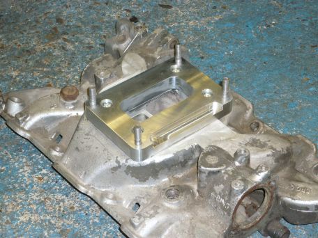

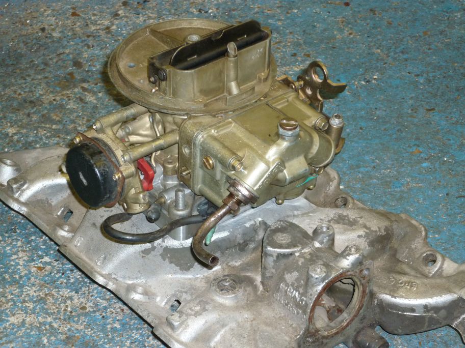

sorted the manifold for stu to use a 2bbl holley :thumbright:
march 2010 003.jpg (164.16 KiB) Viewed 1229 times
march 2010 002.jpg (68.88 KiB) Viewed 1229 times
