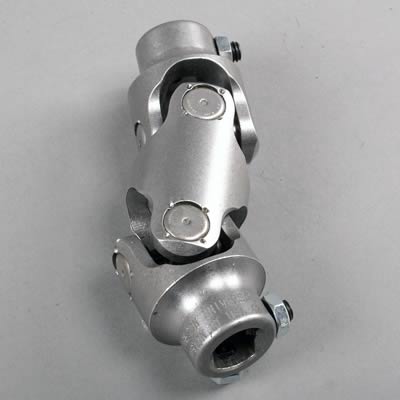

Why not put rack and pinion on it located behind the sump and use a Borgsson joint ( double jointed ) to get the shaft where you need it.
Worked a treat on mine, wheels stayed in a straight line when airborne
valiant wheelie - Copy - Copy.jpg (69.73 KiB) Viewed 364 times
borgsson joint.jpg (12.21 KiB) Viewed 364 times
