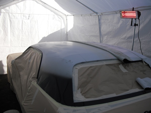

Well I bit the bullet today and started fitting the new vinyl roof to the Challenger. I used an infra red lamp to warm things up, electric heater in the car and a hot air gun to get rid of the persistent creases in the vinyl once stuck down (good tip Dave). I used 3M Scotch-Weld 80 contact adhesive which isn't re-positionable so I had to get it right first time, I almost bottled out because of this. But thanks to excellent help from Sideshow Bob it went on a treat. Only problem was I only bought 2 cans of adhesive which theoretically should have been enough, but I ran out after only finishing between the seams!!!
Oh well, I'll order another 3 cans and post up the results when it's finished.
Thanks for the tips this morning Derek! :thumbright:
