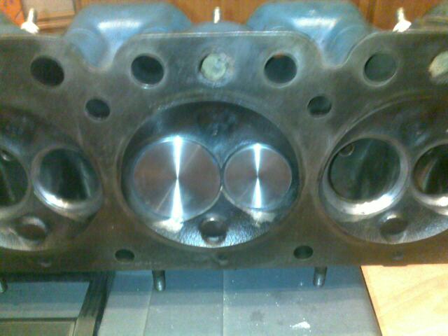

head as standard

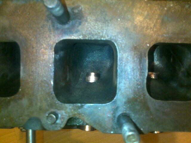

head as it is now below

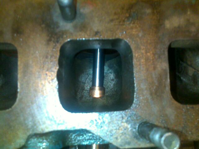

the original boss for the cast in valve guide is gone, lets hope there is enough support for the new guides and that length of valve sticking through the port
saved me hacking at it with a tool in a random manner later on anyway
wasn't what i expected but still certainly made a bit more space in there
more as and when it gets done.
those inlets are nice and big....2.02 for such a little motor
let hope the exhaust can cope
need to clean up ports and get em all the same size and matched to the inlet.
