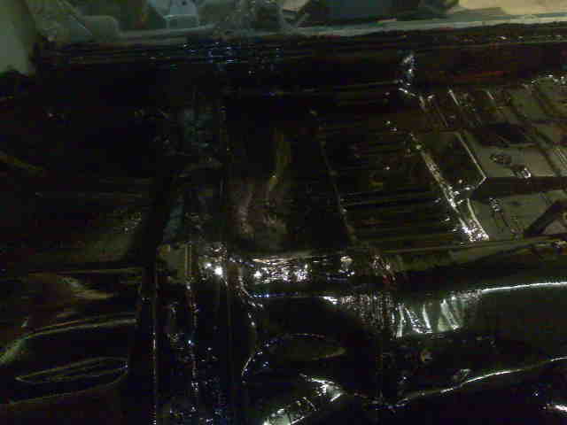

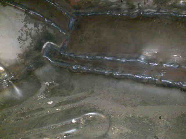

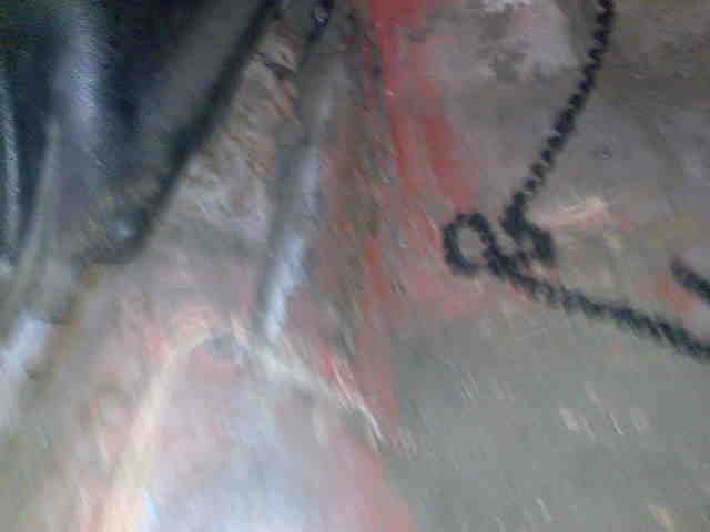

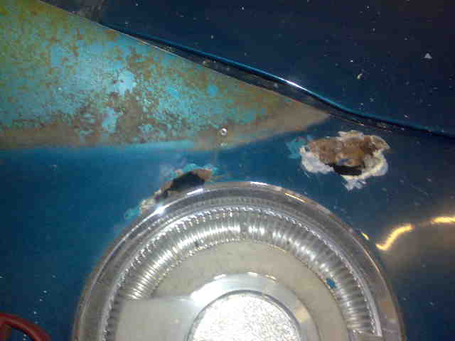

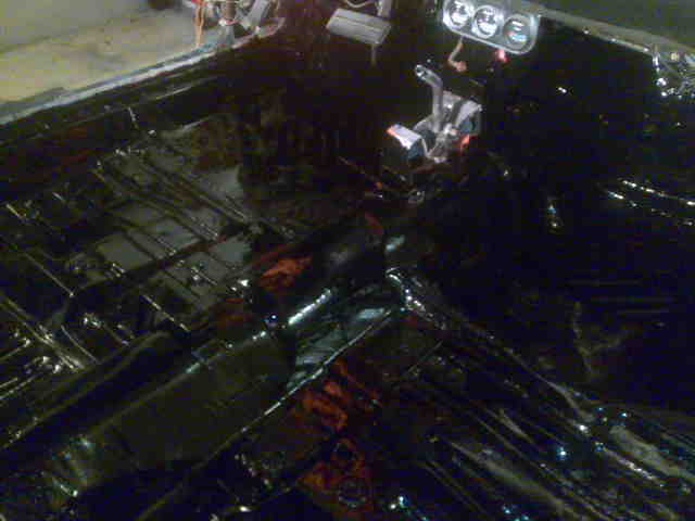

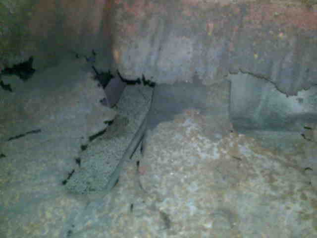

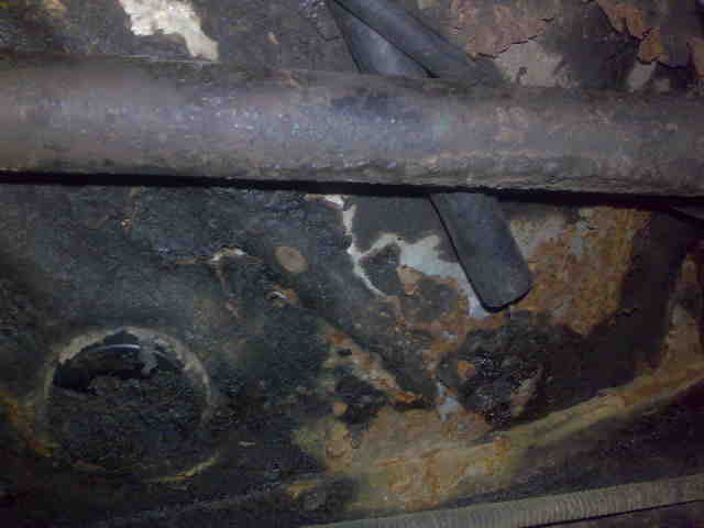

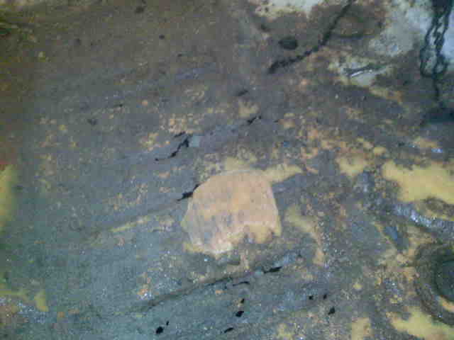

a bit of a update attacked car tonite got seats out and carpet and console also got exhaust system out and prop off and one header undone heres some pics of what was lurking when the carpet came up also found some american change under the seats :thumbright:
:shock: :shock: :shock:

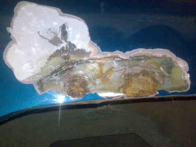

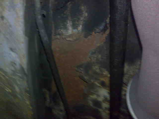

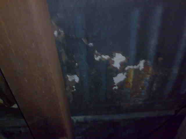

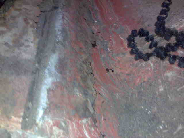

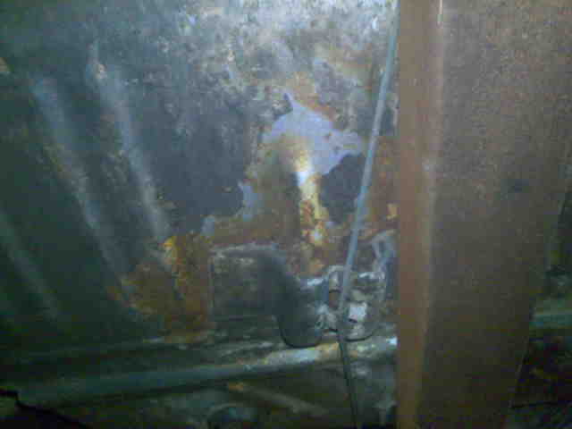

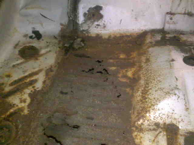

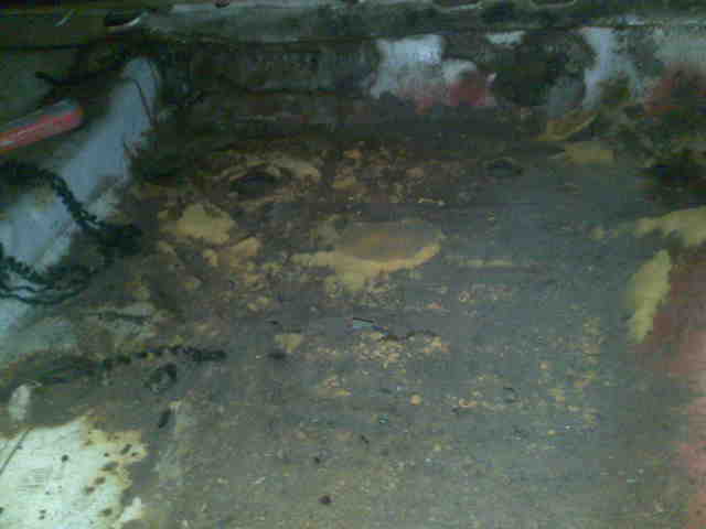

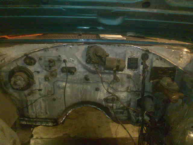

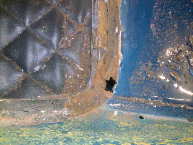

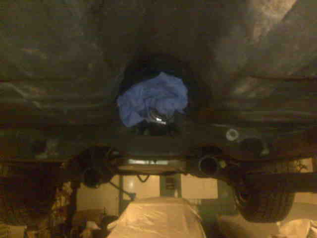

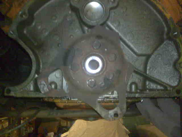

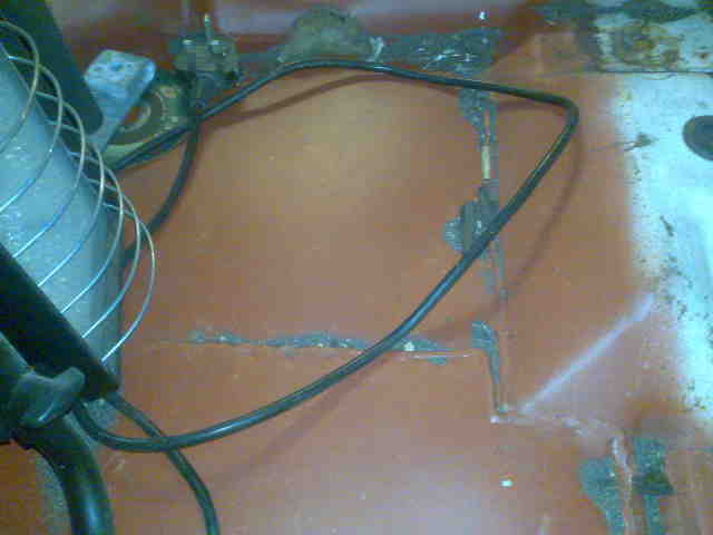

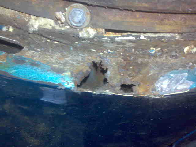

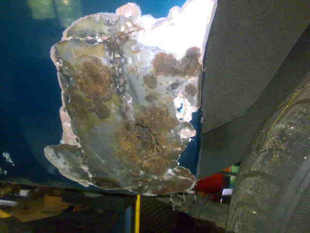

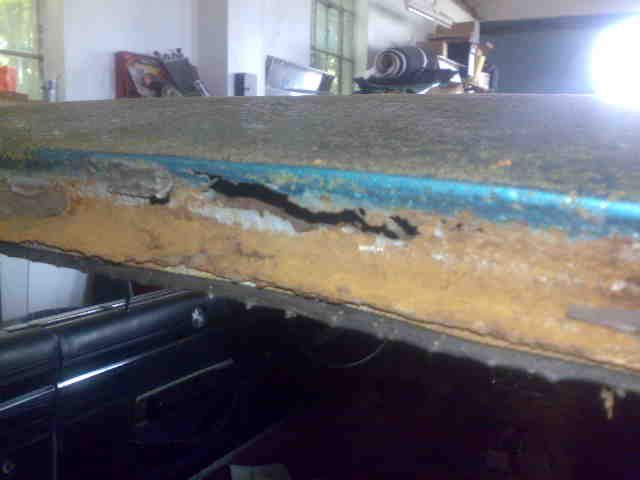

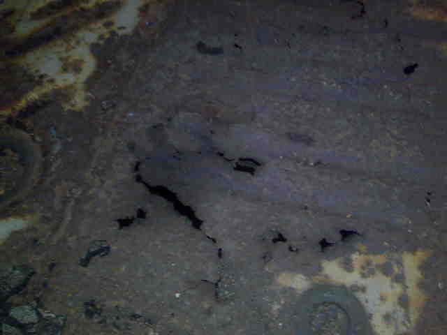

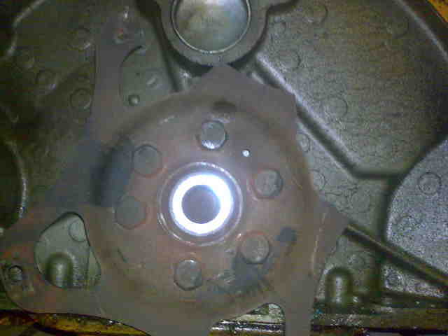

hi everyone heres an update on saturdays work the front and rear glass is out and ive discovered a few holes :shock: :shock: gearbox is out the flex plate was all broken up that must have been the ticking noise i was hearing :shock: :D any advice on this lot would be great ive never been this far in body work wise and some advise on flex plates would be good to heres some pics :thumbright:

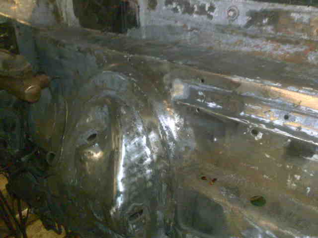

a few more pics i hope im not boring everybody yet :D

Post by latil »
There's very few that aren't like that under the paint and filler,or have already been mended. All that rot around the glass areas is due to the (non) drainage and the trim clip setup.
1965 Belvedere 2 426 Wedge.
latil wrote:There's very few that aren't like that under the paint and filler,or have already been mended. All that rot around the glass areas is due to the (non) drainage and the trim clip setup.
After it has been repaired is there anything i can do to help stop that happening again ???? :thumbright:
latil
Posts: 12076
Post by latil »
Make sure that there's no rust still active,then plenty of paint where the glass goes. For the trim clips,something like Waxoil inside before the headlining goes back in.
latil wrote:Make sure that there's no rust still active,then plenty of paint where the glass goes. For the trim clips,something like Waxoil inside before the headlining goes back in.
Thanks for the advice going to the workshop and getting the grinder on the go :D :thumbright:
Posts: 4226
Agree :thumbright:
Yes that scary, but at least you now know.
Seen worse on here brought back from the dead !! :)
At least you are brave enough to look under the paint/carpet !
Some very familiar looking photo's there,all fixable though!
