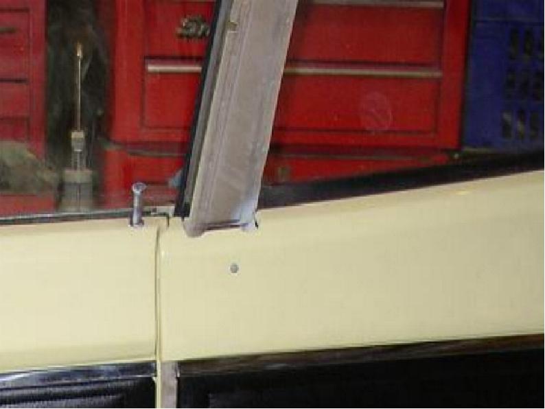

can anyone please post a picture of the interior trim panel that fits the b post on a hardtop 68 roadrunner. no one lists one so i will have to make something a picture would be a great guide
- rrrrrrrrrrrrr.JPG (38.09 KiB) Viewed 685 times

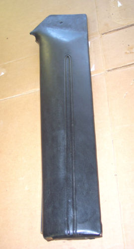

hey nick the panel that you are showing is the top inside rear quarter trim for a charger yours are metal and you have painted them body colour,
i think that the b pillar is painted black and again it poss has a couple of bang over the edge trim thingies like it should have lower down

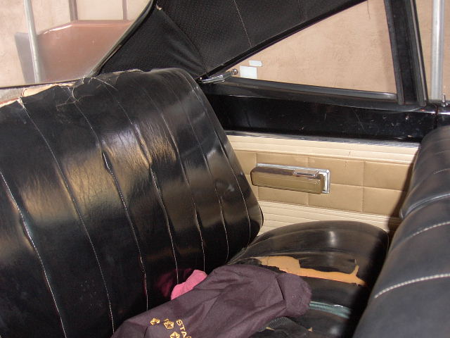

Agree with Dunc.
The B pillar should be painted black and then trim banged onto the front and rear edges... similar to what is fitted at the front of the rear interior trim cards. The trim you are after can be got from most trimming suppliers and is often called 'windlace'. If not they sell it on rolls for Mustangs and you cut off as much as you need. It is textured rubber/plastic stuff with a metal core to hold it in place. Black will be the easiest colour to get too.
Found a pic of a car I imported which just about shows it.
Hope this helps
DM
Hope this helps
DM
- 070905 209 (1).jpg (59.6 KiB) Viewed 591 times
