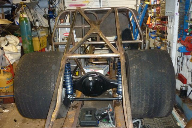

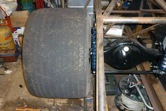

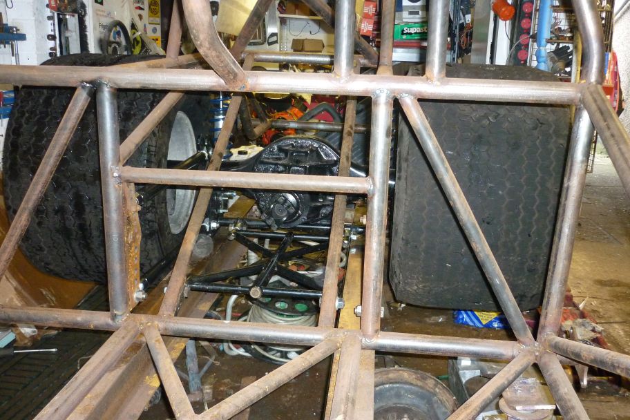

unfortunately lost the thread but here is an update. the 9" fraud axle is now in place, been a long time coming. i have a new lease of life now :D heres a couple of pics of todays progress

hope to have it on its wheels soon, then its just get it up and running before the nats :woot:

baccaruda wrote:Lookin GOOD there Trev!
Sure you got enuff RUBBER there Fella???
Good to see you mate!
Bacca, only slightly green :D
i need big rubbers :D

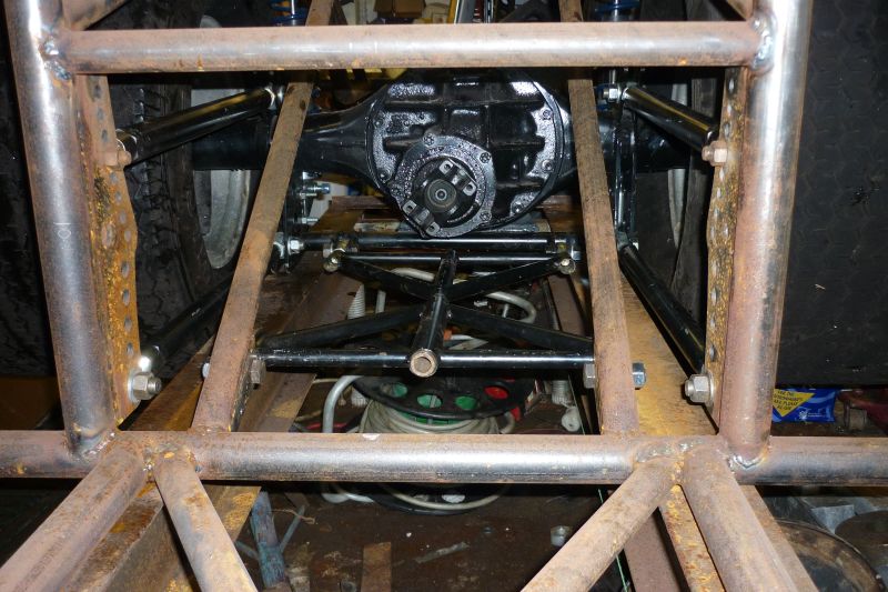

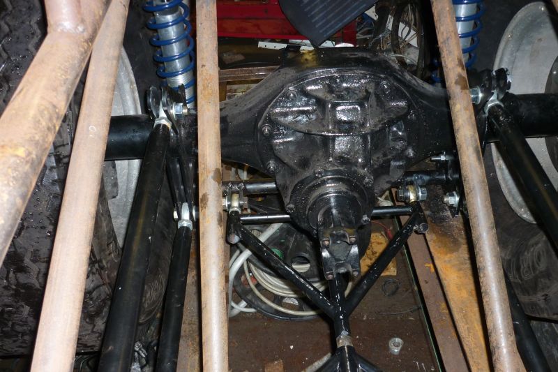

had a good wweekend , the axle is now located in all directions (i forgot to weld the X locator brackets on) heres a few pics of it now, also had a result with the 400 i bought, although it was full of water it is on standard bore so perfect for a big cube B motor.

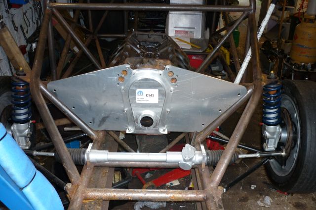

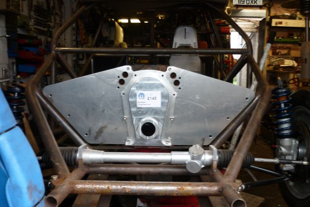

a bit more progress, spent all weekend designing and making the front motor plate, just the mid plate to sort and i can mount the motor. still some work to be done, it will hold the alternator, coil, fuel regulator etc before its finished. and before anyone points out the obvious problem, i intend to make my own oil pump cover plate with pipes exiting sideways :thumbright:

looking good :thumbright: like those front uprights =P~

I would add a type of sadle mount for the motor plate & the mid plate, this will help for ease of engine installation.
Only needs to be made out of 5/16" or 3/8th steel tubing, dont have a phot on this PC, but can send you one next week
