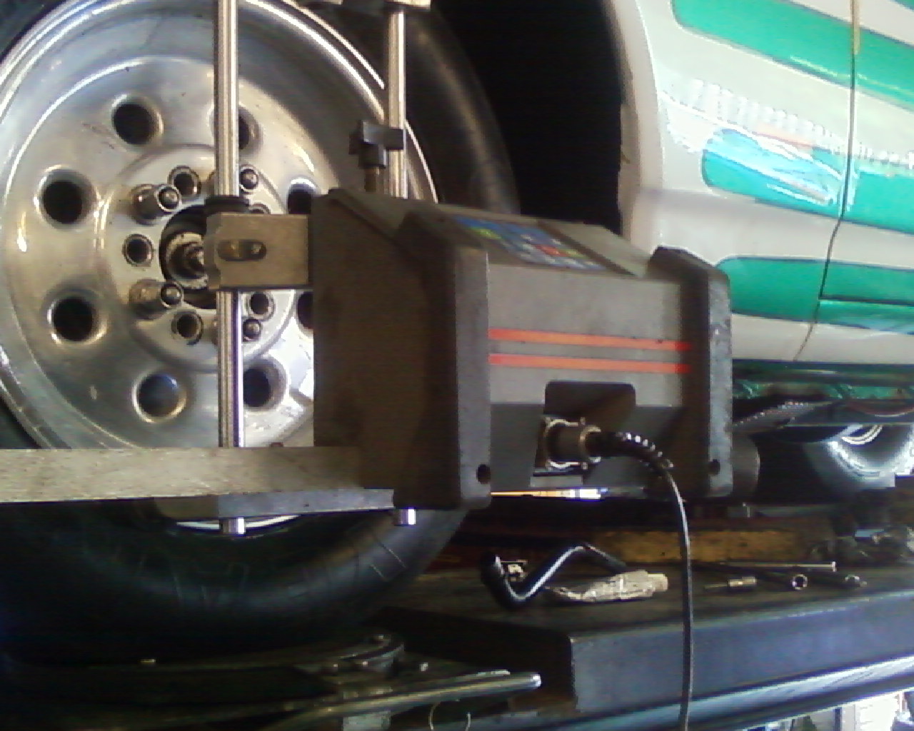

The Chrysler front set up looks crude but is very sensitive. The more caster you dial in the stiffer the steering gets typically a non power steer car had 2% and a power steer car had 4% as the power steering can overcome the the effect.
You will note that the front top wishbone pivot is set higher than at the rear pivot, such that if you hang a string line off the C/L of the top ball joint the caster increases as the suspension raises, this is illustrated in the pics i took when designing my set up. The string moves backwards as you lift the arm.
This is to of sett the bump steer due to the steering linkage.
When I first fitted my arm i dropped the front of the arm on a bracket so the arm was level but I could not dial out the bump steer took out the bracket and it dialled in easily.
Basically the problem is when you dial in more caster you effect the camber bump steer and toe in so every adjustment creates three more.
Now this adjusting is virtually impossible to due accurately on the garage floor so the only way is to use a 4 wheel computerised alignment system so that you can make the adjustments and see the effect on the other settings,
even then it is a compromise.
I managed to achieve a good set up and 8 degrees of caster but it still took k 8 hours to fathom out what the hell was happing as you tweaked it.
If you want to loosen the front end on a standard Chrysler set up I would look to the torque arm stiffness first.
