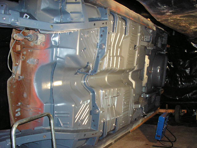

Hi Folks,
What do you think of this?
Bacca and Mas.
Rotisserie Resto.JPG (72.48 KiB) Viewed 1869 times

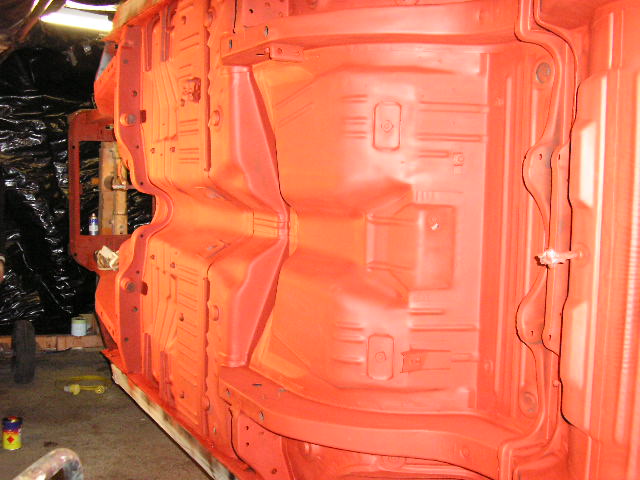

Resto red floor.JPG (68.39 KiB) Viewed 1867 times

cool
67 Charger ?? :-k
Yep Steveo,
First of many, form a queue LOL! :D
Baaca, no sheep till Ashford :shock:

Shouldn't the underside be dark Grey primer, with over spray round the edges :? :lol:

This is a mint 67 Charger, totally rust free, unlike mine and lots of others I've had the pleasure to work on LOL! :roll:
Bacca. :D
ps, the red is the primer DOH! :shock:

GTXJim wrote:Shouldn't the underside be dark Grey primer, with over spray round the edges :? :lol:
That's right.
Mopar never painted the underside of the cars. Just dark grey primer with overspray from the top side paint.

Right or wrong,the more coats of paint underneath in our climate has got to be better. Perhaps finish in satin grey topcoat?
1965 Belvedere 2 426 Wedge.
I had 2 pack stone chip put on mine. Stuff originallity, it wants to last. The new owner will thank me for it (unless they like the onset of corrosion). A pointless route to go down if you are gonna 'use' the car IMHO.

Clivey wrote:I had 2 pack stone chip put on mine. Stuff originality, it wants to last. The new owner will thank me for it (unless they like the onset of corrosion). A pointless route to go down if you are gonna 'use' the car IMHO.
yep thats true Clivey as nice as it looks & factory appearing , no good if your going to use the car as it should on our roads !! started going down the same route when i done mine !! i mixed up a dark gray 2k formula from the colour map book , that looked close enough , & put 70% matting additive in it , thumped 4 coats on , then coped the factory type over spray ! then a few months later !! decided , with our climate , & was not really looking stock anymore with chassis conectors & torque boxes , plus i sealed up all the seams on the under side , to stop any damp moisture ! sprayed the whole underside in dark gray stone chip , & over sprayed it with yellow , & black stone chip in the wheel arches following the factory pattern loosly :shock:
It makes sense.The people who built these cars weren't known for their quality or attention to detail. Seeing a survivor like that is cool. Replicating it? WTF!!!!
Jim wrote:That's right.
Unless you ordered underseal as well. ;)
