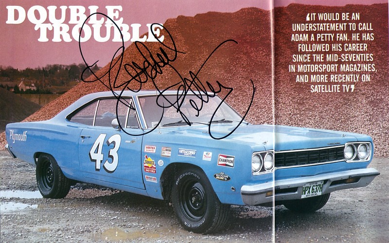

When my old Satellite was my daily driver, I painted the front bumper with smooth Hammerite! Looked OK on a pseudo stock car, but probably wouldn't suit your limousine :)
My 43 autographed.jpg (173.74 KiB) Viewed 717 times

That front bumper looks good from the pic.
I think my luxo barge would definitely look better like that than with nasty rust!
Please tell me more about the Hammerite paint. Is that a sliver finish or more reflective?
Also is it a spray paint, a aerosol can or a good old pot of paint so you can slap it on with the same brush you use for cleaning parts with. :oops:

Steve, it was just a pot of silver brush on paint from Halfords. I think it's called "Smoothrite". I've tried spray on "chrome" paint in the past, and it doesn't last 5 minutes.
