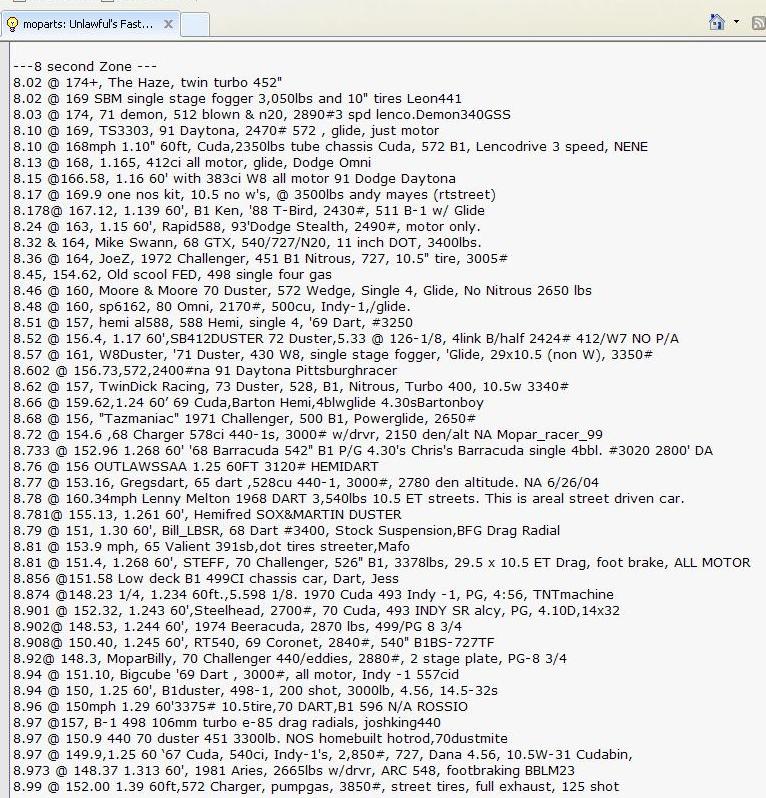

8 second smallblock
I know there are a few in USA now
But will we ever see one here ??
- 8 sec.JPG (182.65 KiB) Viewed 1211 times
I don't see why not, the parts are out there now to build one without getting crazy - R3 blocks, stroker cranks to get up to 500ci
, Prochargers or turbos, or pick up ex Nascar or Pro Stock truck engines with very exotic parts for cheap. There are many ways to skin that cat.
None cheap, but for similar money people spend on BB's.
Hell someone posted a stock block 360 running 8's in a Duster yesterday!!
