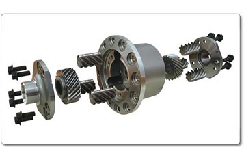

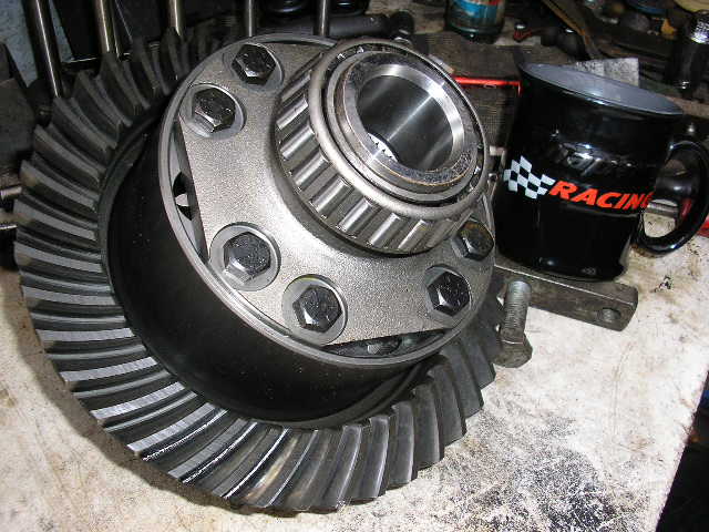

Hi Moparfolks,
This is the new kid on the Block.
'Eaton True-Trac' once the Ford only locker is now available for Mopars!!! :D
Works as an open diff for street driving and turns into a full blown locker once on the gas!
Have fitted a couple of these now, but Mopar-Al will be blasting this one down the 1320 with 700 horsepower with a mission to run a 10 and still drive home again in one piece!!! :thumbright:
Bacca.
Mopar-Al True Trac 2.JPG (64.22 KiB) Viewed 983 times
Mopar-Al True Trac 1.JPG (78.71 KiB) Viewed 983 times
