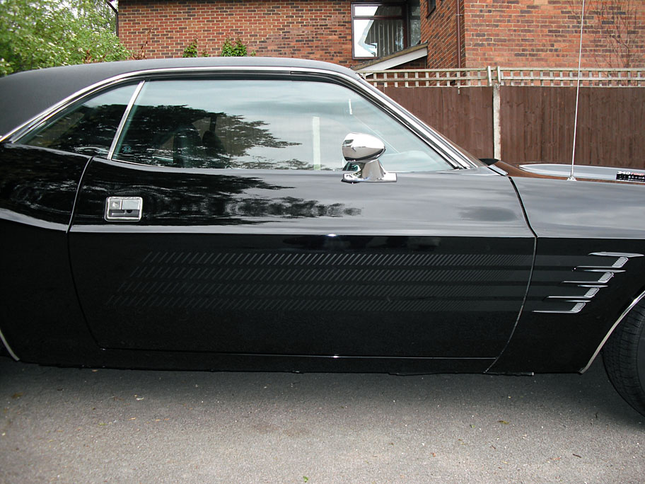

- 3M Matt black strobes
- DSCF0078.jpg (171.23 KiB) Viewed 525 times

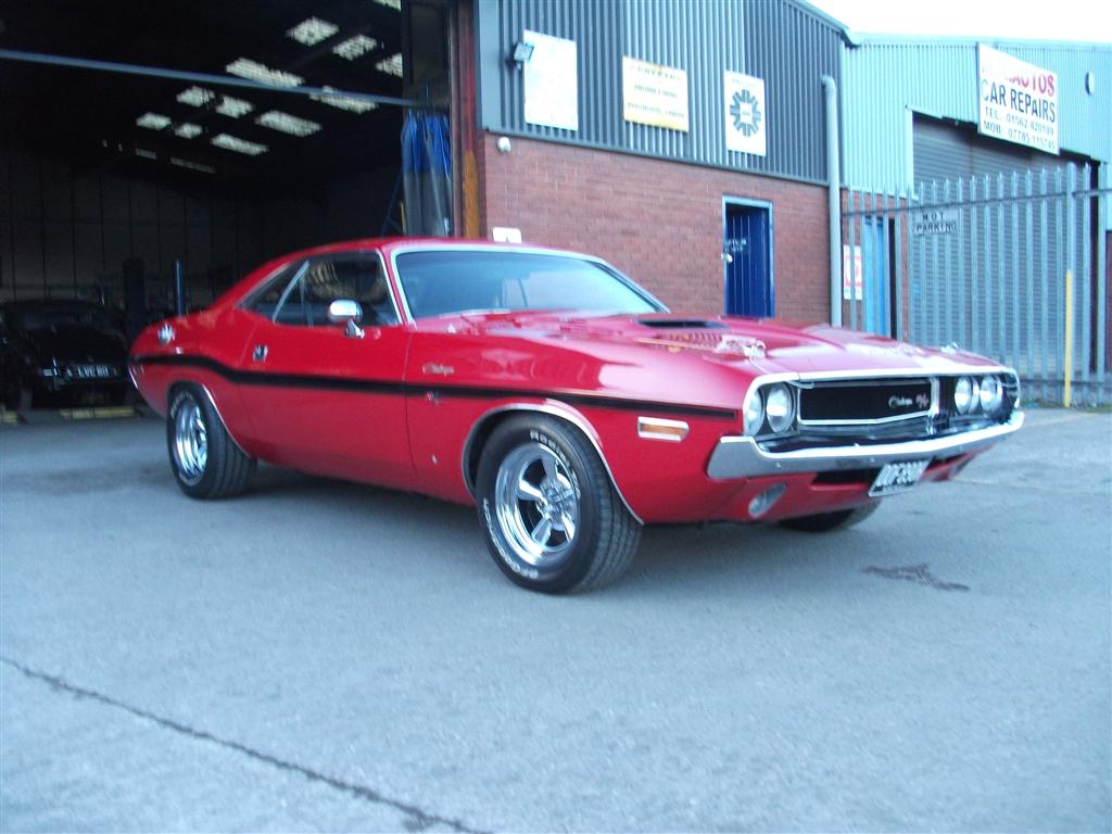

i fitted r/t stripes a while back, they reccomend using soapy water and a plastic spreader as martin suggests, you should have one in the kit, i did mine dry but did have a lot of air bubbles some of them you can pop with a pin, but it took prob a few months for all the bubbles to go heres the stripes.
- my chally 008 (Large).jpg (98.27 KiB) Viewed 501 times
keep it mopar !
yeah thats the one was a bit rough but its getting there , spent alot of time and money on it. needs a re spray really but im going to use it as is dont mind it getting marked then. cheersTyreFryer wrote:Is it this car? http://www.moparuk.com/forums/viewtopic.php?t=34666
