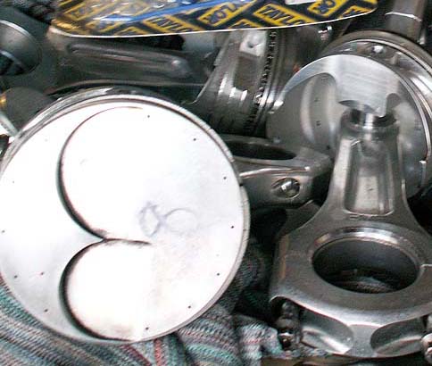

I have now got the quote for my new pistons.
The original pistons were gas ported and wondered about the merits of this feature.
so the question is "to gas port or not" that is the question

This is an interesting site and I think I may have answered my own question.
http://www.rehermorrison.com/blog/?p=29
go to link click on tech talk and go back to tech talk 22 interesting stuff.

Yes, I would gas port, as done previously ;) I guess your still using custom pistons, so gas port cost is not really an issue & in consequential really
Yes Mark still going Venola but bore now 4.450 and looking to use low friction rings.

That's what meant Mark if you worked it out at the time then I have a chance it is right as I have sent one of the original pistons to Venola as a sample.
I will still check but at least I know I am in the right ballpark
