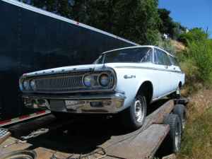

Jon Connolly
Posts: 3116
Post by Jon Connolly »
Nice one Jerry :thumbright:
How about a 65 Cornet to tow it to the track ;)

Nice wagon that Jon, but got enough on with this at the moment, bit more progress made today, Craig has completely bare metalled the engine bay now, and me and Marc went down today and finished making the cage, it is now all tacked in, will fully tig weld it when the cars been on the rotiserie and had the mini tubs and chassis conectors put in, here are a few pictures of the progress

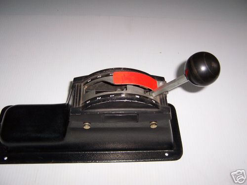

Posts: 13000
Jerry, how about a nice vintage Winters shifter?
Go this one going spare! The red bit is a flip over reverse lockout.
