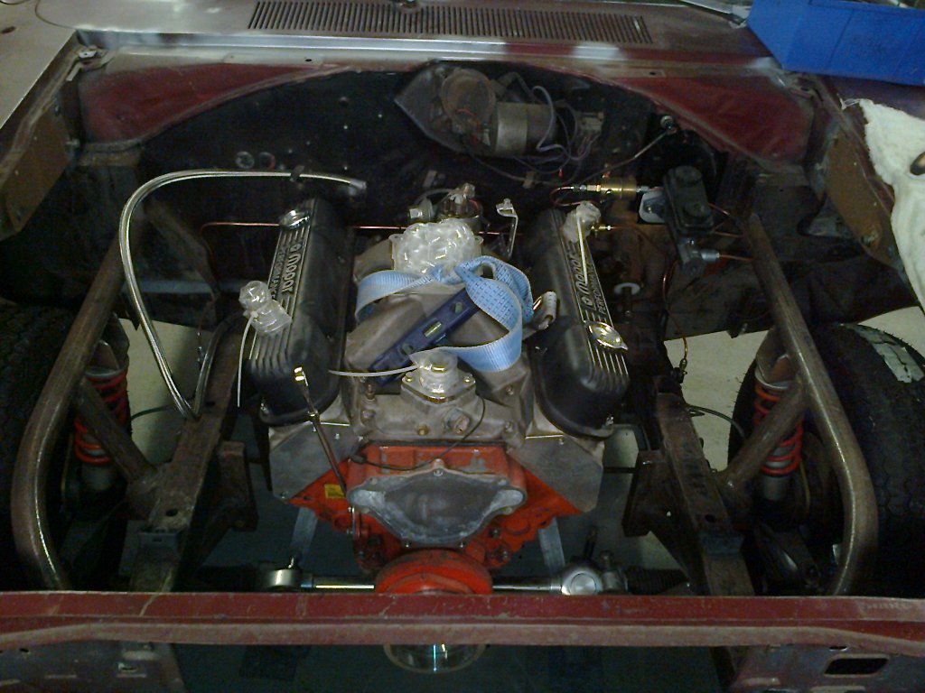

I'm about to make a plate for my hot-360-totin' Belve.
Anyone have one they photo for me?
Is a mid-plate really necessary? (trans mount is poly)
Any advice on dimensions and frame mounting would be great please, mancini, chassis engineering, etc sell 'em from 3/16 to 3/8 thick! :help:

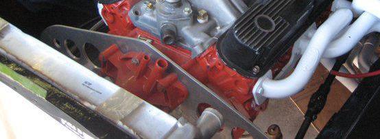

Also Alli for your front one and mild steel for your mid plate. This is the Moroso front plate with 2 no M8 bolts each side straight onto chassis rails

This is mine Paul ... give me a few weeks and I`ll send you some better pics ( knackered my back )
The water pump pully is the " thickness of the plate " out of line ... this can be sorted by machining the back of the water pump pully and front of water pump pulley flange i.e. if the motor plate is 3/8 then machine 3/16 off each face then put the pulley on with the std bolts and everything lines up
Make sense ???
