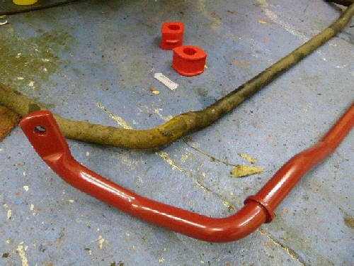

My Corvette came with Z06 brakes/suspension. But the front anti roll bar is badly corroded from road salt so the wife treated me to a pair of aftermarket sway bars.
Now these new anti roll bars are a hollow design same as the old ones and only 1mm thicker or so than the old ones.
But they weigh 2lbs more (12lbs vs 10lbs) so obviously they must have 2lbs more steel in them. Maybe thicker walls.
2lbs is 20% more steel.
So my question is, does that mean these bars will be 20% stiffer in operation???
nope, alot more variables than that I would imagine, depends on what toughness the new ones are made from & extra diameter will give you more than the % increase, wont be a linear relationship, I imagine some body on here will come alongs with x y z & expain it properly

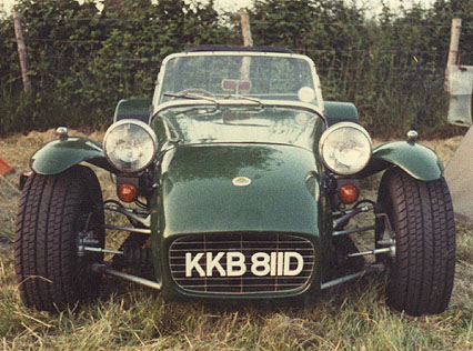

Andy's absolutely right, it depends all on the hardness of the bars themselves, on my old Lotus Super Seven, I upgraded to a stiffer anti roll bar that was exactly the same thickness as the original bar, but seriously stiffer.

depends on the spring constant K of the spring and that workls for all springs not just wire wound coils
function of cross section and the treatments done on the material in question
i.e you could have two identical bars formed
heat treat slightly differently
and end up with 2 differet spring rates
one will be "stiffer"
you new bar could look identical
in size shape and thickness but with different treatment be stiffer
or they could treat both the same and just make one fatter
or make it out of a different alloy
spring rate shouldn't change unless spring is pushed past its elastic limit
i.e gets fatigued and not elastic anymore. i.e never goes back to where it orginally started i.e elastic hysterisis
over stretching or physical degradation are both candiates for causing this
and in your situation i'd say your orgianl will be showing signs of less springyness
i.e its buggered
new identical spring
or new higher spring rate spring
will certainly change handling
you'll have to tell us if its an improvement
spring stretch is linear in the elastic region of the spring i.e K is a constant for that spring
i.e 1 gram hanging on it causes 1 cm strecth 2 grammes will cause 2cm and 3 will cause 3cm K=1
but your new spring has a different K so the relationship between the two is not going to necessarily be linked just by mass or thickenss K might be 10 for your new spring 1 gramme causes 1mm strecth 2 causes 2mm strecth etc
or 100
i.e its buggered
or 100

ahha you can work out what K is now
stick em both in a vice (soft jaw of course)
push 1 with set of bathroom scales
measure deflection for 1kg push a 2 kg push and a 3 kg push may be do 4 as well
do the other
plot on force/defelction graph and work out the slope of the line you plot
force/deflection = k with no units of messurement its just a multiplier
use it to work out spring rate in your chosen units lb/inch N/M etc
do the other

Dave, the problem would be deflecting the bar in the direction it works in (twisting). That would be simple enough to compare the two bars if you could do that.
But somehow I suspect that measuring the deflection would be tricky in a home environment.
The force applied would have to be very high and the deflection (twist) would be very small. In particular on bars like this. Remember that rusty bar I am replacing is designed for weekend track use. The replacement is an upgrade to that. So this is a very solid and highly rated bar indeed.
