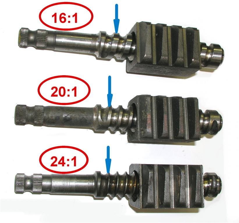

here is a picture to help you spot a rare 16:1 Formula S or 68/69 dart option 16:1 steering wormscrew and ballnut
i know few have manual steering but i guess the ballnut and screw thread pitch will be similar on 24?6:1 and 20:1 power assist boxes
so may be usful
spot the difference with the other picture
and don't be tempted to buy the other for car use unless you don't know if you are coming or going
16:1
16:1

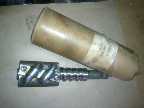

That truck version would keep you on your toes...turn left and you'd be going right!
Or have I got that back to front?
Or inside out?
Or not at all... :roll:
Posts: 9563
excatly
i nearly paid 100 for that
then compared with a 20:1 one i had to hand and all became apparent
still trying to work out what the aussie stuck in their RT/Police only 16:1 box
was truck length i.e short necessitating a longer steering shaft
but it sure as hell didn't go backwards
that one is off a 60s d100
the others are all standard length with the barracuda S one being the aim. can keep my column then...why the aussies didn't just use that is strange.
all based on Saginaw design so maybe a chevy or ford one will do the job
