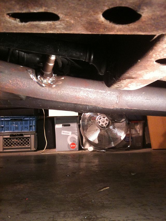

Thought I'd fit the O2 sensor next.
Some O2 sensors have an internal electric heating element , some just use the exhaust heat to work.
The sensor with the FAST efi kit has the heating element, and it's recommended to fit it at least 20" away from the heads .
Any closer, it could get too hot . Too near the tailpipe, and the reading can be affected by outside air mixing with the exhaust gases.
Also the sensor should point downward from horizontal . This prevents moisture & condensation from accumulating inside it.
Found a suitable position just near the torsion bar mount. Had to drop the exhaust to get access to drill & weld.
There's a threaded bush provided in the kit to weld into the exhaust pipe. It looks to be stainless, but seemed to weld OK to the mild steel exhaust just using the MIG.
The sensor has a multipin connector , and just plugs into the efi loom .
