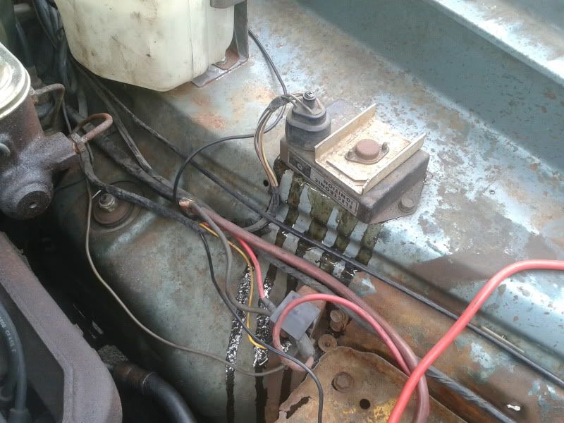

Finally after 8 months got the car out today in the sun, and had a good look around the engine bay. Being a 72 its got the Chrysler electronic ignition and 4 pin ballast resistor.
One of the issue, queries that i have is first the Ignition module.......
As you can see its seen better days! I have no idea what the gel type substance is (been there since i bought the car)? When hooked up to the battery you get a distinctive fizzing style noise from it, so understanadbly would like to remove and replace.
What would you guys recomend?
From my initial research it seems i can replace with new Orange/Chrome box, replace with HEI/GM type and ditch the ballast resistor, or bin the lot and go MSD or similar..................Opinions please?

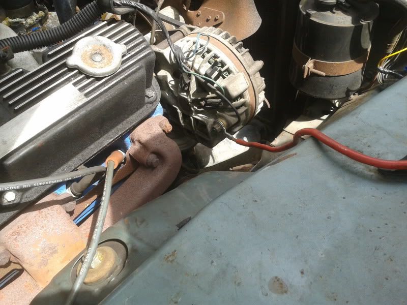

Second, one of the things that seems odd to me is that there is a battery style cable (thick wire) running directly fro the Alternator to the + Battery terminal?
The only info that seems to coincide with why this may be done, is for instance, you had upgraded to a Denso style Alt. According to one website the original Mopar squareback gives out 35/40 amps. The Denso gives out 90Amps and as such the wiring is not built to handle that amount of power.
A way around it is by hooking up straight to the battery +'ve terminal, thus saving it frying the standard wiring?
I don't believe my alt is anything but standard Mopar though..........Any ideas, my only other guess is that its not supplying the battery as it should via the normal route and thus draining the battery over time????

The thick wire has been added to bypass the troublesome bulkhead connector the only problem with it is if it rubs through on any bodywork its always live..

Bin the lot and fit HEI. Smal neat and works better than the chrysler system.

Dave wrote:Bin the lot and fit HEI. Smal neat and works better than the chrysler system.
Yea it is the best route,as those old modules will melt in the sun sitting on the window sill,that melt down is typical :x

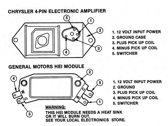

1972 chrylser puts electronic igntion on cars..the modul is supposed to be a product of work they did for the moon buggy.
its basically a transistor that replaces the points with a small circuit that picks up signal from the meganetic pickup in the new Dizzy...
apart from not having to repalce points and a slightly better tollerance to dizzy shaft ware....its no better than points due to the limits imposed by the electronics.... it can only switch the same current as points i.e 2-3 amps
1974 oil crisis and smog. GM and many other manufatcures decide they can't beat the Govt into submission over impending federal rules regarding emsssions and catalytic converters
the invent a cat that is not very good and discover that if it gets lots of unburnt fuel in it it stops working and goes on fire
they build HEI as a solution....make certain everything gets burnt...
its a chip which has in it a circuit with takes trigger signal from a magnetic pickup in the Dizzy and uses a variation on the transistor as a switch theme for the points.....
but this time
it can handle 5-7 amps..
so instead of usuing the not very good round oil filled coil with a solid iron core
they use something akin to the transformer you find in a valve radio.
laminated iron shim core much better at doing the magnetism stuff than a rod of iron due to limiting eddy currents and better magnetic flux concentration
they relaise that this thing is going to get hot
so they impliment a dwell circuit that changes the dwell beased on the resistance of the coil and the RPM
they tune it so the dwell is limited at LOW rpm
system can provide a good spark on a v8 from 1000 to 7000 rpm
mopar box 40-150 quid
HEI module £17 + shipping
this would do the job
http://www.ebay.co.uk/itm/E-TRON-D1906- ... 5ae2ce2e7c
basically
go to hardware place
get section of angle iron
cut to shape of module
leave tab on the other angle
get big jubilee clip
clamp bracket with module mounted to dizzy
2 wires from Dizzy pick up to module
and two wires from module to new 12 volt coil
diconnect old loom
connect all ballast resistor wires together
run a fat wire from there to coil +
start car and set timing..
as you coil gets hot its resistance rises and the module detects this lowers the dwell to let the coil cool again.... its quite clever
been running mine for 10 years and replaced modul last year as part of a general refresh due to intermittent electrical fault.....still don't know what that was...

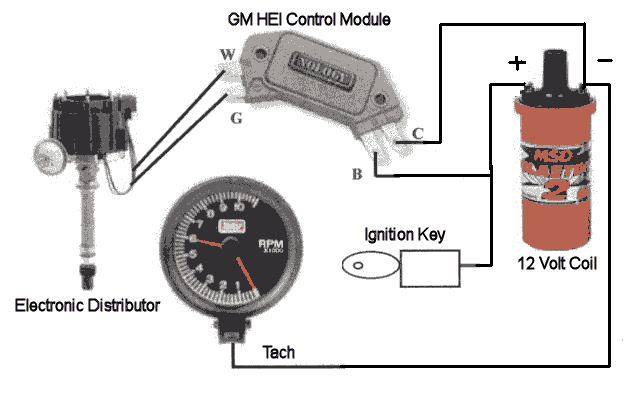

got to get the wires from the dizzy the right way round or it won't work
other than that
very nearly plug and play if you have a 12 volt transformer coil to hand (anything off a 1 coil 80s/90s machine that looks nothing like the round coil we are used to.
or using the pin out picture
mount the module in the guts of your old mopar box...
swap coil and by pass ballast resistor with loops of wire and piggy back spade connectors
keeps it looking standard
your mopar 8 volt coil will die a quick death if you don't run a ballast

From what i understand though is you upgrade the mopar box to the GM HEI and upgrade the Coil, there is no requirement for the Ballast Resistor?

Yep that's right, don't see a ballast resister on any GM HEI engined cars, really neat, simple and cheap :thumbright:
Don't mean it'll never fail tho', I had plenty of late T/A's require the odd component but still cheap to repair ;)
