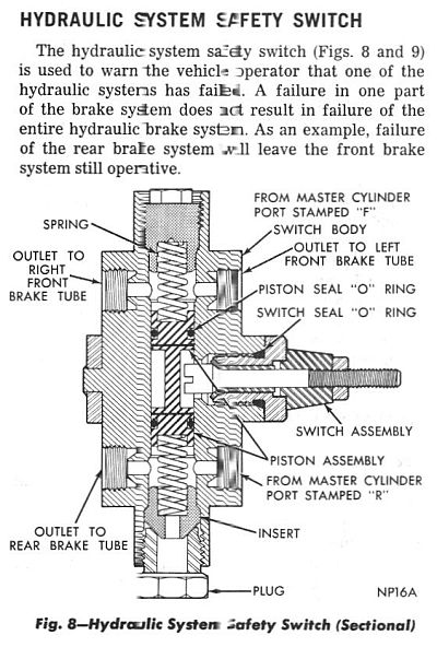

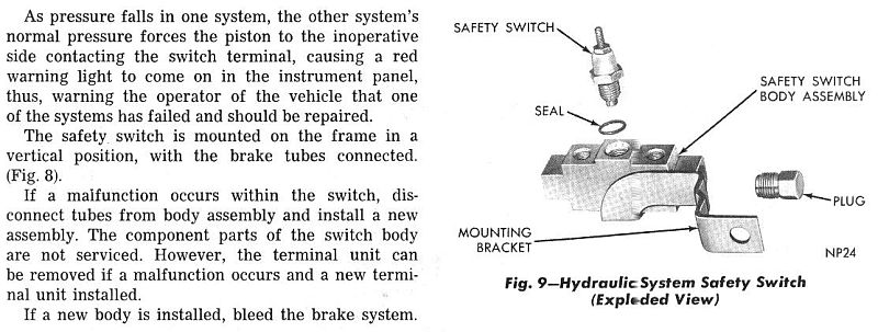

Might help?
witorque wrote:When the wire is disconnected, the light goes off
I removed the electric switch and plunged it by hand, the light goes on & off
No sign of the internal shuttle going back with a 'Tock' when the switch is removed.....
It looks like the second photo in -grey one shown here
http://inlinetube.com/Prop%20Valves/pro_valves.htm
You can see by the diagrams I posted that the switch works by grounding against a piston in the middle. If the light is coming on then the switch is shorting against the piston or the body of the switch.
The switch is adjustable for depth. If the threaded bit is screwed in too much it will contact the piston under it and make the light go on.
So I suggest you think about how it works by looking at the diagrams and then you should be able to suss out how the switch is grounding itself.
It does all come apart if you need to clean it out.
I don't see how the switch works if you remove it and plunge it by hand. How is it finding a ground to the battery -ve?
