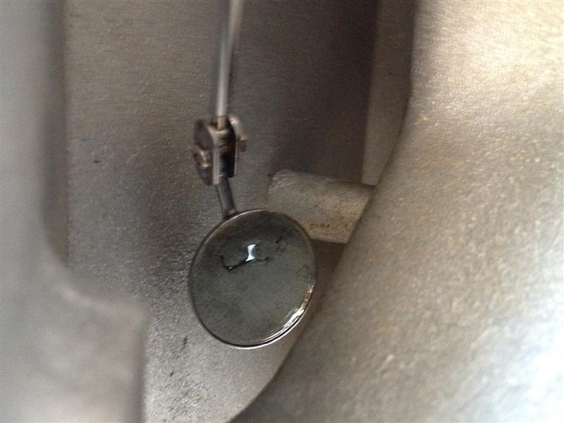

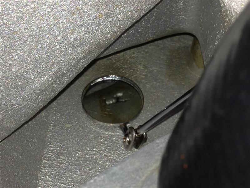

I pressume this is not a performance enhancing breather hole in the under side of my new inlet manifold :shock: :evil: I noticed it today when wiping round the engine bay as there was some staining appearing on the flat area. If I put a torch underneath you can see light from the top with the carb off :shock: Definately dodgy casting as the hole is smooth on all all edges and appears to be a splodge rather than a crack. I now soley blame this for my runs of low 16's on Friday :lol: and not my wheel spinning agressive starts :lol: Looks like I'll be calling the supplier in the morning :roll:
Manifold hole 2.jpg (49.8 KiB) Viewed 958 times
Manifold hole 1.jpg (89.95 KiB) Viewed 958 times

Took ages to work out what was going on in the first pic, then I realised it was a mirror!

:lol: Yeah sorry I always do this on here, get the pictures the wrong way round every time. If I ever get round to putting pictures up of what I do to my car it would look like I'm taking a perfectly good car apart and replacing all the parts with broken bits :lol: :lol: Mind you with this Edelbrock RPM Airgap that's exactly whats happened :shock:
Does it go right through? You can see light or poke a wire through?

Yeah it goes right through :( I have a video with a torch underneath and you can see light inside with the carb off. I didn't notice it when I installed it cos the hole is difficult to see even from upside down. To honest I seem to remember un packing and fitting straight away, doh :oops:

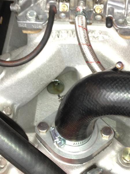

If you didn't get the manifold from a UK supplier then I would just have it welded up. Or just epoxy a patch over it with a fuel resistant epoxy.
You might even get away with a fibreglass patch.
Obviously it would be tricky to drill and screw a patch over it due to the difficult access.
Posts: 22110
You did well to find that, not an obvious fault.
I would get it welded up or drilled and tapped and a plug inserted for quickness..........I have some very high quality epoxy that would do it, but I do not know how long it would remain fuel resistant........you are welcome to try. I am not a million miles away.........

Pete wrote:You did well to find that, not an obvious fault.
Not sure you will get access to the underside with that being a small block air gap manifold.
Posts: 22110
Do it from the inside...
Oh I thought it was further down the runner than that. :oops:
