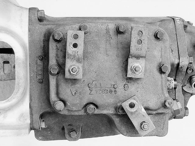

It's jammed in 2nd a couple of times before and it's done it again today. I previously ran it with ATF for a bit to Bananarama! and now it's on decent 80/90 so it's got no excuses!

Shifter and rod adjustment.
There is normally a shaped tool you insert into the shifter that indexes them and you then set the rod lengths accordingly.
Alex Doing and I made one and set up the AAR that way.

I've been through the rods etc the previous times it's seized Pete, I took the rods off and found the shaft into the box wouldn't budge. I worked it with a big adjustable and managed to free it. After speaking to Ade last time we decided the synch cone must be a bit knackered (I did stupidly drive it at the start with no oil :oops: ) I hoped it would sort itself out but apparently not...

when it was working did it change down ok ,i had a box in the demon with no syncros and that didnt jam up ,i think petes right in saying its adjustment,i used to have a bit of aggro with my 4 speed ,but i put on rods that had rose joints on them ,where did you get the box

Brewers sell a rebuild kit for around $100, sycro rings are extra if you need them. It's a pretty easy job rebuilding these box's, I don't think you'll have a problem. You will have to make a dummy cluster shaft to hold the cluster shaft bearings and thrust washers in place when you assemble it. I turned a length of delrin down but I've heard of people using a piece of broom handle.

I'm almost certain it's NOT adjustment- with the rods removed I put a big adjustable over the shift plate on the end of the 1-2 shaft into the box and it wouldn't move. I worked it back and forth for a few minutes, then it came free. I've not done that this time yet but it went exactly the same way.

We had a client with this problem too (finally it wasn't me having 4-speed for once lol) and without the shifter rods attached it still didn't want to do anything. After opening up the box the problem was on the inside of the gearbox side cover, the rod assy between the 2 shifter pivots we're jammed (probably because bad adjustments in the past) so it was almost in multiple gears. Was a simple fix.
But if it's more then that there is no rocket science inside a 4-speed so just give it a go. Just let me know what you find as I have a partial rebuilt kit myself (haven't synchro's in mine so they're still there) which might contain the parts you need.
I took off the side cover last night and it's just as Hans says- it had's fully disengaged from 3rd when it went into 2nd so the levers got stuck. There's no seizure in the gears themselves.
Looks like you guys were right, down to poor adjustment. In my defence I did it properly with the rod through the shift levers, I'll double-double check it next time!
I'm still going to do a full stripdown as the front bearing has a lot of play, it has a few leaks, and I'd like the peace of mind to know it's all cool in there.
