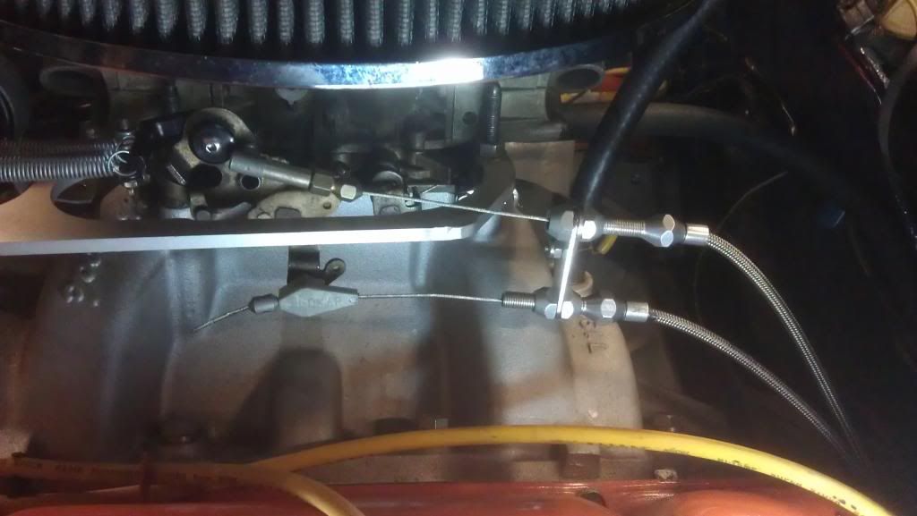

John
Posts: 1904
Post by John »
Thanks chaps,
This is my set up so slightly different but all adjusted now :thumbright:
