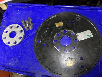

As Chevys have the starter ring gear on the flexplate not the converter you need adaptor and flex plate TCI, ATI do these.Kits use mid plate do adapt housing you wont need that with Ultrabell. Plates put mopar starter in stock location pretty sure Ultrabells do as well.
I have a TCI 8 bolt adaptor and flexplate(out of tag) if your interested.

If you get a chance, please could you post up some pictures of the adapter.
I may need one that is in tag, but will bear it in mind.

here you go Pete
Posts: 22137
Thanks Cliff!

Posts: 6740
Pete,
Couple more piccys for you ;)
Tried to show a Starter packer
My old ring gear (130 Teeth)
Posts: 22137
Ahhhh!
Starting to make sense now. :read2: :thumbright:
