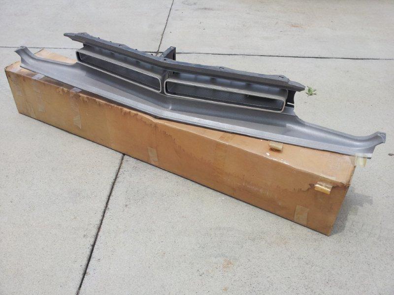

Need to strip my 71 Challenger grill and want an effective and least hassle way to do it. Long story short I already laboriously stripped the 'dummy air intakes' (basically very fine detail and major PITA) once and then ruined them with watery rubbish MP paint. So they need stripping again but also the main grill. That also has a lot of bare black plastic which is dirty and stained, so i would be nice to have that looking better as well. So I'm thinking some kind of blasting possibly (soda, walnut ??) or a chemical stripper that works and will also sort out the bare plastic.
I'm fed up looking at this, I'd appreciate your suggestions!
Thanks
Not mine but in case you don't know what it looks like..

Here is an example.....
This is the back of the grill, in it you can see the bare plastic, and the castellations of the front of the grill. It is a nightmare to sand, and I already spent a bit of time doing that but it will take forever to do by sanding
That's why I'm thinking a chemical stripper or blasting. The metal bit is also hassle but not my main concern...
