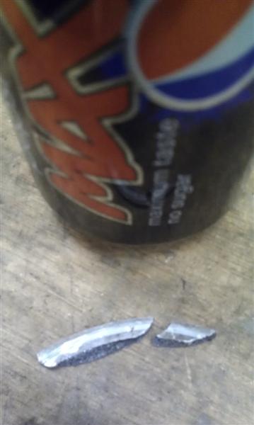

Anyway, got that sorted and a few weeks ago I decided to drop the sump and have a look at the crank just to make sure all was still ok, got a bit of a shock as I found what turned out to be to pieces of piston, they're from under the oil ring, one bit was in the sump the other in the oil pick up, don't know how long they had been there.

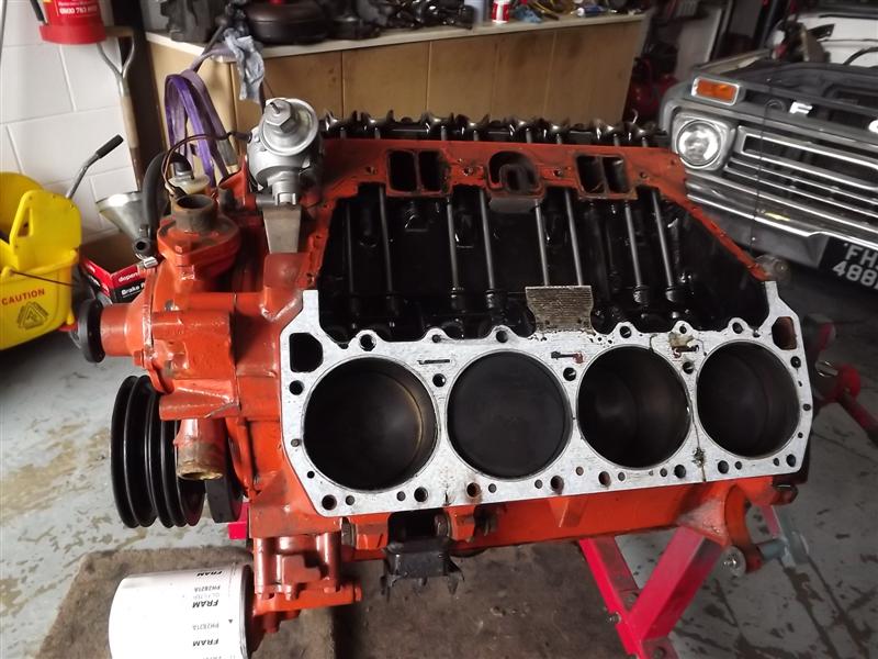

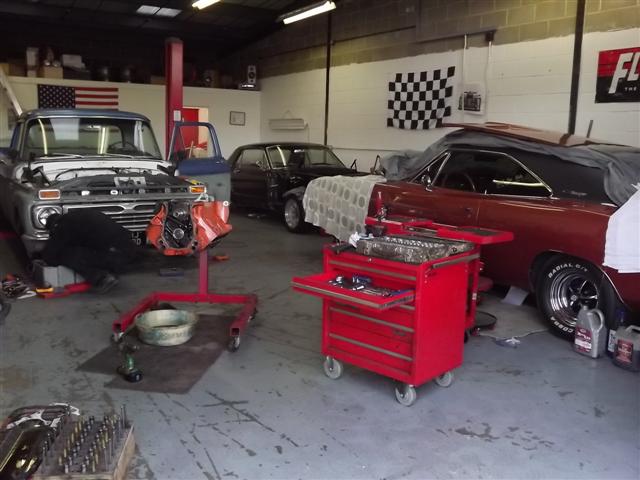

Saturday morning drove the Charger down to Anton's workshop and within a few hours with the help of Anton and Andy Clarke engine and gearbox were out and stripped down to a bare block, crank still looks good with no marks on it.
Anton gave me the keys to his workshop so that I could go down there over the weekend, I haven't been happy with the look of the engine bay since the garage fire two years ago this easter, I spent a couple of hours today cleaning the bits you can't get to when the enging is in and now it's looking like it used to, much happier.
I'm going to hone the bores put in new shells and rings, I'm going to have a word with my Scott to see what parts he has in his garage so that I can crack on with it, if he can't help I will have to order the parts and wait, should have it all done by next weekend though. [-o<

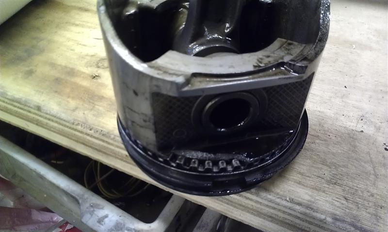

Ouch !!!
Any idea what caused the piston failure Del ?

I am sorry to here your engine is giving you grief. Were they new pistons or the old ones?. lets hope you can get a set PDQ What oil do you use. I was going to ask at wheels day how she is going glad I didn't :shock:
you will need to fully strip that out derek, and clean it 100% cant hone a bore in situ imagine the grit going round
Posts: 7516
Cannonball wrote:you will need to fully strip that out derek, and clean it 100% cant hone a bore in situ imagine the grit going round
Duncan, the pic doesn't show it but it's stripped down to a bare block. :thumbright: it will be honed then cleaned.

Cant iagine what would cause the piston to fail like that unless something has gone wrong during the casting/forging process?
Here's hoping that the damage to the rest of the internals is minimal! :thumbright:

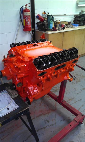

While the engine is out....[quote the dodge]......why don`t you paint it the "CORRECT" 1968 colour? :roll: :roll: :roll:

R.RUNNER wrote:While the engine is out....
Andy, orange it is then. While it's my car I will do what ever I want with it, If you want to buy it from me and change the engine colour you are welcome to. ;) :) ;) :P :P :P
