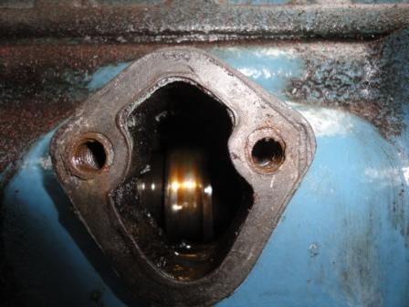

Pete had identified my fuel pump on the hemi 6 was not up to much, and this showed on the strip as well at the top end with total power loss.
Just got a new pump in from Aus, checked the installation was right and found this.
Chocolate cam that was new in 2003 has the lobe completely rubbed off that runs the fuel pump, just a big groove round it. Its even worn the shoulders of the pump lever.
No Nats this year with the Charger then, this is engine out to change the cam, and see what else is damaged. :?
No time at the moment so will have to put it in storage until the Challenger is in fewer pieces.
Bugger, I thought this was an hours job this morning, now it won't even run.
chocolate cam lobe.JPG (35.26 KiB) Viewed 390 times
pump wear.JPG (29.36 KiB) Viewed 390 times

yeah but what caused that ...
sticking pump
too strong pump spring ?
lack of cam lube breaking in the new cam lobes

Stick an electric pump on for now, get you on the road quickly.

Might need to lift the inlet and check a lifter or two...
Posts: 9563
is there a ridge? hard to tell.

Steve, I did wonder if the spring was too strong but it is a standard pump.
Cam was after market from Aus in the 80's so maybe a poor batch??
