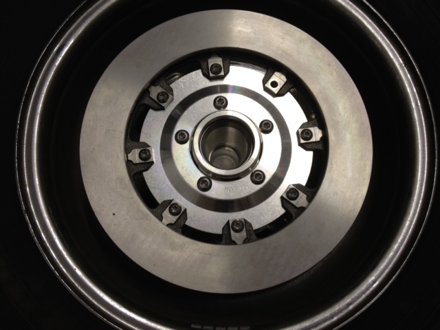

Fitting wilwood kit - hub to disc, 5 x t40 torx bolts. Requires 55ft/lbs torque.
Have now shattered 2 torx sockets - they go bang around 40ft/lbs. looking up the specs of a t40 it looks to be around 40 is the max ( surprise surprise)
Q - how the heck to get them to 55ft/lbs ??
Anyone got a super high strength t40 recommendation ?
At the moment its looking like 39ft/lbs and a ton of loctite !!

b) Go see the nice men at trident and get some proper bolts for the job. I cant see why it has these torx things anyway - it doesnt seem to be for clearance ?

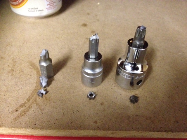

Now that sounds like a bet Wil. Might have to take you up on that. But I fear I would break your tools and take your money ! Here's the results of this evenings fun - I got to 40, then at 44 - bang !

Thought these pics might amuse.
The remains of all my torx. 44ft/lbs is my record, held by the one on the right. Still short of the 55 needed.

The culprit. The 5 bolts in the middle. Grr. Like I said, I reckon they need to be shallow headed bolts....

I almost didnt post this - but what the heck - I'm not too proud. It was my error which has caused the expense and destruction. Long story short, the centre bolts were actually t45 NOT t40. No, I dont know how I didnt twig - tired, harrassed - whatever. What a bananarama!
Turns out once I used the t45bit it CAN take 55ftlbs...
Of course, as a side effect I now have a few borked bits and need to replace a couple of slightly chewed bolts, but progress is underway again.
