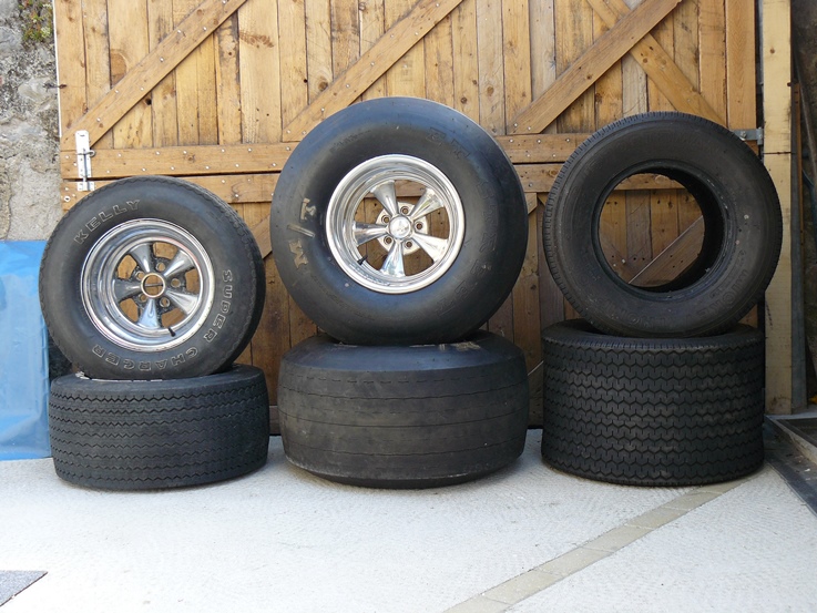

Hmm, not sure if I have enough wheels and tyres...
Well, I should be able to work something out with this little lot!
Plan is: Get the original 18.5" tyres fitted to the ally rims, this time with no tubes and with the paint dots correctly aligned with the valves, lets see if that helps the balancing!
I'll get the ET Streets fitted to the new chrome rims and sell the Kelly Superchargers. At 27" diameter they'd throw the gearing out.

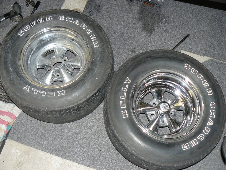

The new Cragars are pretty old so have the usual rot hidden by black paint. Not too bad though, it mostly polished out.
- My wheel collection.jpg (206.38 KiB) Viewed 1743 times

- New Cragars.jpg (182.46 KiB) Viewed 1743 times
