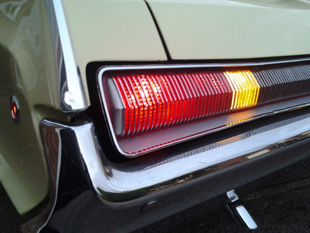

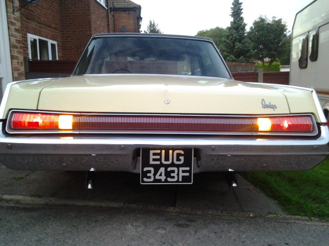

All done....followed your instructions Miles and works a treat! Loved the old sequentials but orange much safer and no worries with MOT tester. Had to fit a new indicator switch from States and all works great, :thumbright:
Nice one Steve.
And what a lovely rear end you have there sir ! :D
Posts: 7462
Why thankyou good man....any may I say, yours is mighty nice aswell :lol:
