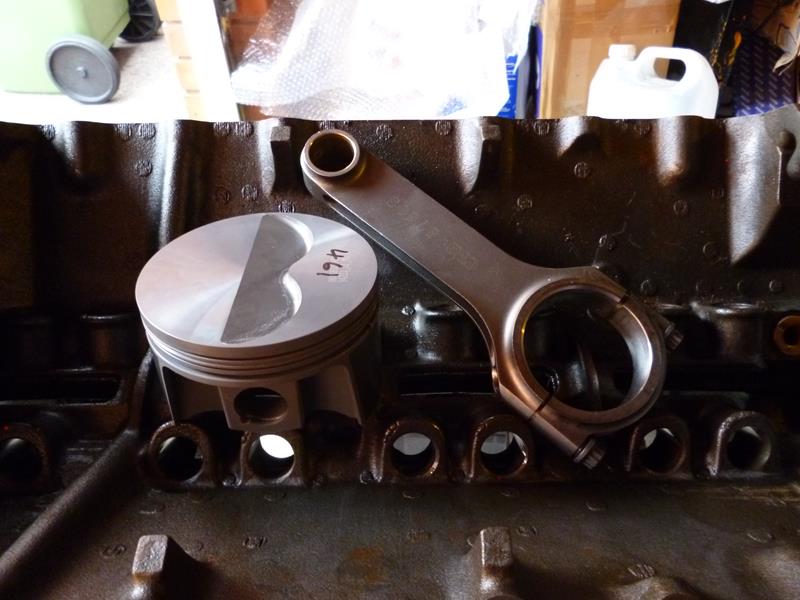

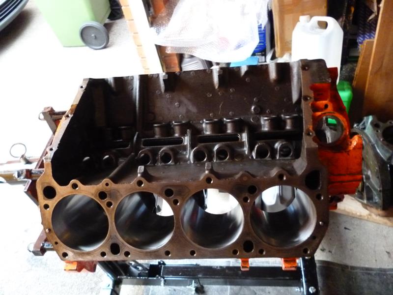

Recently, I dropped off the 440 block, that, was part of a motor I had bought from Justin ( Dart Vader) some years ago. I was on a std bore and being a 73 block, the pistons were 150 thou below deck, so, I have bought some 6.760 rods from Turnip and a set of Mahle 30 over pistons and rings.
Picked up the heads and bored block today for a test build before final machining / balancing.

30 over 440
30 over 440
Mahle piston BBM065350F08 and 6.670 rod
