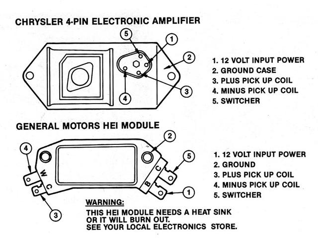

Gents,
been reading lots of old threads etc on this and fancy tackling it as a Winter project....
As usual I am reading so much that Im starting to go round in circles a bit. To simplify it, could someone please answer the following questions....and sorry if the answers are already here, Im reaching saturation point so may have missed them...
1. HEI unit earthed in a similar way to orange box....case to ground basically, I like Daves idea of a small bracket jubilee clipped around dizzy. Is it ok to earth it with a lead to the rear engine earth or similar??
2. Is the MSD blaster coil the preffered option still? I understand that if I use one, then I can bypass the ballast resistor.
3. I dont want to buy the wrong stuff so does anyone have the part number of a quality GM HEI unit that they would recommend I go for please....
thanks in anticipation
cheers Steve

the HEI module earths by one if its bolts
bolt to metal that touches metal that touches engine and its earthed

no ballast, short it out
just make up a lead with piggy back female/male lucar spades (in the Halfords bumper box of connectors) and join both ends of ballast together then plug in what was originally there onto the piggy back spades.
bobs ya mothers special friend
if you want to keep it standard
dig out all the gunk in your busted old mopar box
undo the big transistor
snap off its pins and glue it back on to the front of the box
bolt the HEI inside the box
wire it thus
and plug in your old loom
and do the ballast resistior jumper as described above

Fantastic gents .... Cheers. Ive been reading all the stuff that has been put on the forum about this and it seems quite straight forward. I am going with the MSD coil in black as I want the standard look....just want to make sure I get the correct HEI unit as the search for that throws up a few options...
Thanks again
Thanks again
For the Unit (ignition module), i went with the Petronix Flamethrower and as above the Blaster 2 Coil.Steve wrote:Fantastic gents .... Cheers. Ive been reading all the stuff that has been put on the forum about this and it seems quite straight forward. I am going with the MSD coil in black as I want the standard look....just want to make sure I get the correct HEI unit as the search for that throws up a few options...
Thanks again
Most recon you need a heat sink too, to help prolong the life of the Module. Most just bolt them to the inner fender, or firewall and use the bodywork. Some use Ali blocks, others go ott an make housings to try and keep engine bay temps away from it......or go one step further and have them housed inside the cabin.
