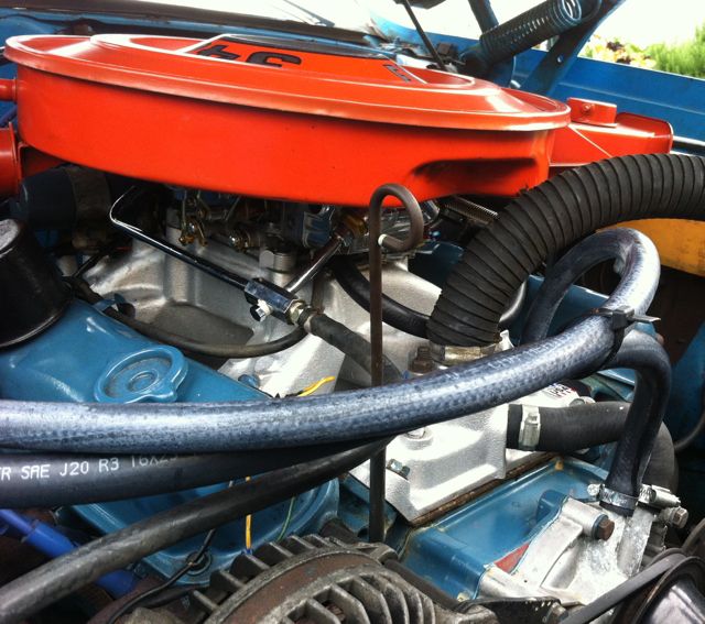

Once I had bolted it all down it is a simple process to reconnect the wire to the temp gauge, ensure all hoses are refitted and carb is fully connected. I then offered up the original 340 air breather and was pleased to find that it cleared the hood.
Additionally, the kick down linkage and throttle cable despite being higher still connected and work well as the pics show without further modifications.
- carb linkage.jpg (61.35 KiB) Viewed 420 times
- man clearance.jpg (80.67 KiB) Viewed 417 times

Finally, the road test! I warmed up the car and went for a blast. Whilst the carb was off the car I upped the jetting as the manifold was going to flow better and need more jetting. I went for mains at 68 on the Primary side and 74 on the Secondary mains and it pulled really well.
There is a clear improvement in torque and at 3,000 rpm the cam comes on song, the secondaries are firing and it really pulls much harder than before going by the 'seat of the pants' test.
All in all a good £300 worth of improvement
- plym side.jpg (23.82 KiB) Viewed 414 times
