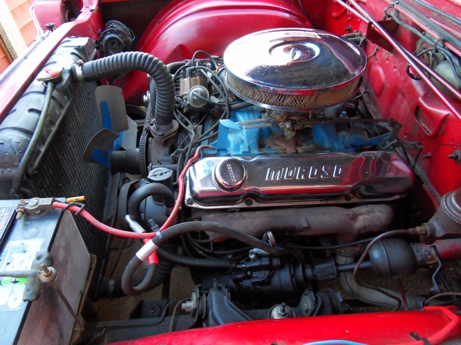

The water pump is noisy so Ive stripped it out today while I wait for my gasket set to arrive. I have a spare pump that I bought from Mick last year so that will go in. While its out, I am going to paint up the pulleys and the radiator in satin black.
Seats are out, steam cleaned and ready for me to try to re colour the inserts....watch this space.

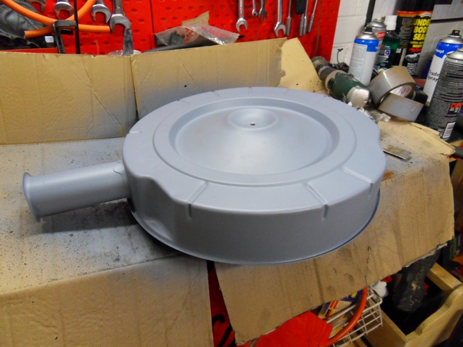

Going back to original on the air cleaner and rocker covers. I've stripped and painted the original air cleaner housing and will put original style rocker covers on that are on their way from Terry. They will be blue as per original.
Ive put new and additional earth straps on the rear of the block and from the alternator bracket to a radiator mounting bolt.
Battery tray was rusted up but solid, so thats now stripped and painted and back in.

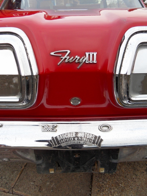

fury rear.JPG (197.61 KiB) Viewed 2883 times
fury 3.JPG (194.08 KiB) Viewed 2883 times
fury 2.JPG (201.8 KiB) Viewed 2883 times
air cleaner painted.JPG (199.93 KiB) Viewed 3077 times
air cleaner primed.JPG (198.26 KiB) Viewed 3077 times
air cleaner stripped.JPG (182.54 KiB) Viewed 3077 times
air cleaner 1.JPG (191.46 KiB) Viewed 3077 times
water pump out.JPG (230.97 KiB) Viewed 3071 times

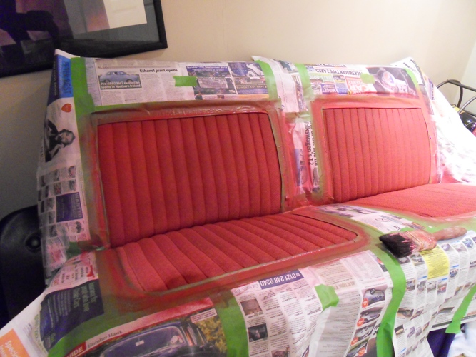

Just sprayed the seat inserts with fabric spray dye, looks ok so far..fingers crossed it drys ok!
Cheers Steve :thumbright:
seats sprayed 3.JPG (181.8 KiB) Viewed 3017 times
seats sprayed 2.JPG (190.89 KiB) Viewed 3017 times
