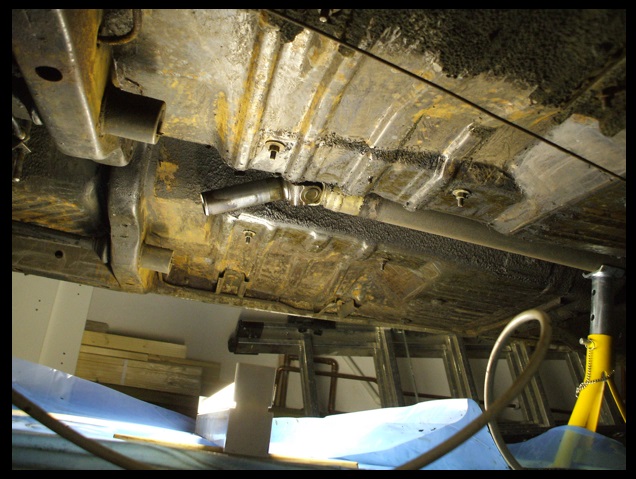

I scraped off the whole thing over the course of a winter (long job). Mine had been undersealed at some point in its past, which seemed to have done the job. Couple of patched bits from YEARS ago, but thats all.
Once clean I used POR15 on the metal bits like frame rails, stonechip undergaurd (spray type) for flat surfaces and waxoyl in the crevices.
Stonechip stuff sticks well and can be scraped off in future generations if required. Seems good to me... Although like you, it wont get wet often.

- Scraping off the gunk.

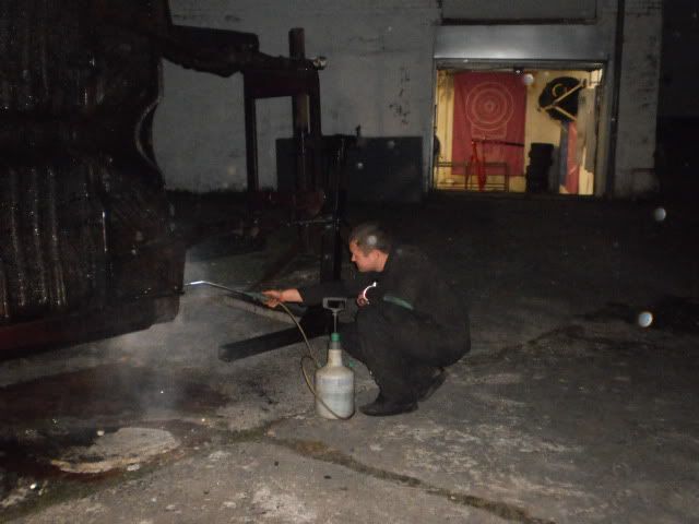

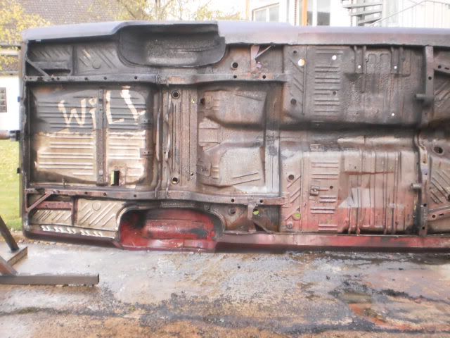

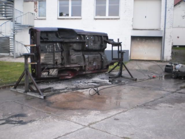

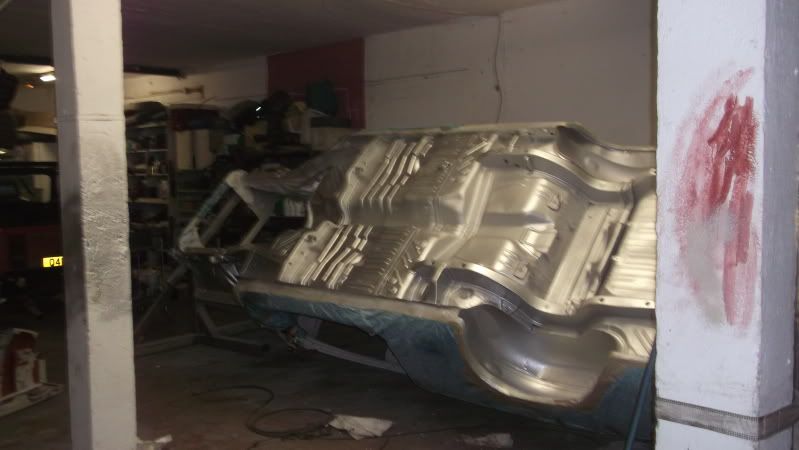

I sprayed 50l of diesel at the underside of the car.
With a 200 degree 200 bar jet Bananarama! came off like hot butter.

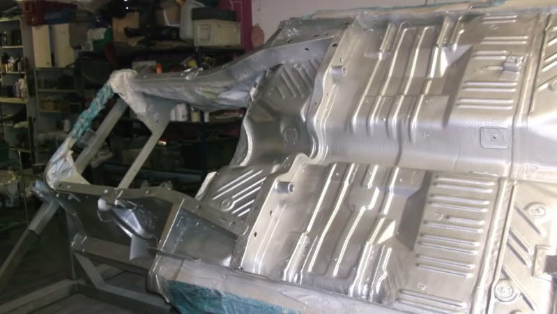

Sand blasted it to bare metal
2k etch primmer
3m seem sealer bushable
3m stone chip over spray-able in a shussllleee gun
chrome affect mirror paint
2k scratch resistant clear coat x 5
Good luck

That's pretty stunning Will. Great job.
Mine was all blasted and primed with red oxide, then Isopon Zinc 182 and then a gloss grey enamel brush painted on.
It sort of looks like the original primer only effect but has some proper protection on it. I'm more wanting longevity than factory finish.
