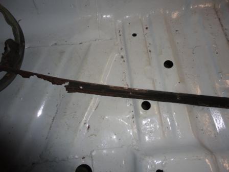

Photo of the knackered remains is here.
If anyone has even half usable ones to keep me going to the Nats that would be good, or I might look to the states as there are some complete rubber kits on ebay for not bad money like this one.

thanks for checking Dave, My outers are the problem, as per the photo.
I have taken the plunge and ordered that complete 17 piece rubber kit from Texas. I will report on what it is like when it arrives. Whole lot came in at £219 posted which seemed good as it is all the door seals, and trunk seal.
