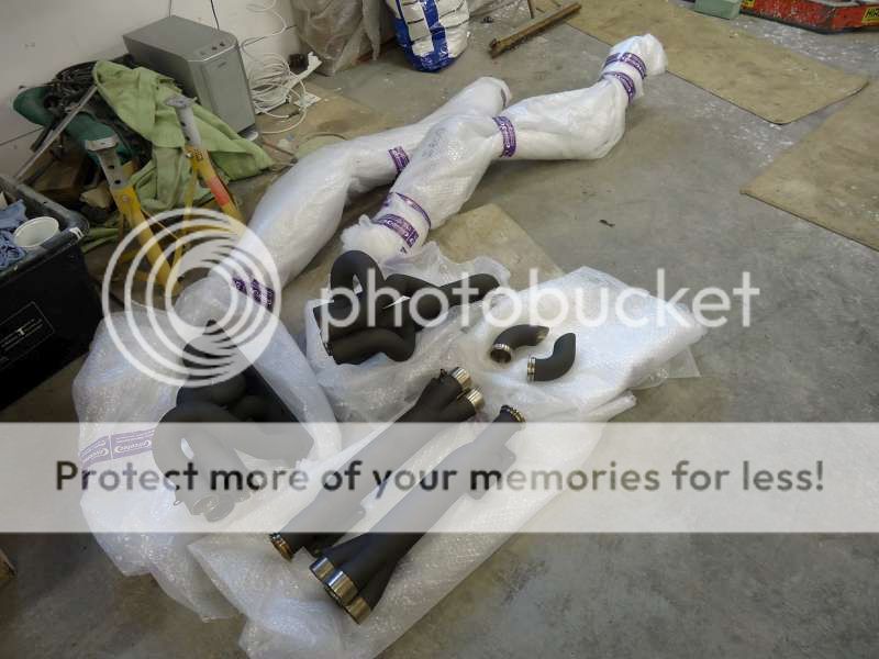

I had Zircotec coat my headers, great friendly service, really pleased with the finish, and plenty to choose from.
Wasn't the cheapest, but seemed to offer the best for what I needed.
I got nice discount when I told them Andy Frost recommended me, was around £200 off
I would use again...

Regarding Chrome, will help prevent headers going rusty & looking good.
My headers are all stainless, the reason for coating was to reduce under hood temps. The Zircotec I chose reduced temps by 40% & also helps with aiding spent gases...
