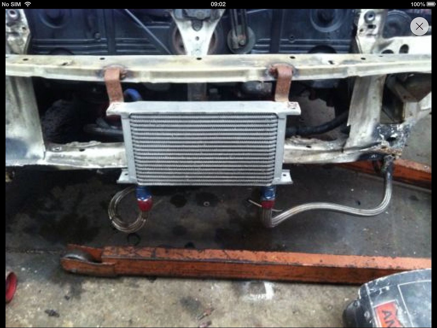

2x silly questions
1. Can it be mounted upside down like picture ?? ( I would say no but loads are Like this !!!!)
2. Can I paint the cooler I don't see why not but thought I would ask.
Any advice before I try to screw 2 oil coolers to the front on my car :roll:
Thanks in advance
<a href="http://photobucket.com/" target="_blank"><img src="http://i73.photobucket.com/albums/i205/ ... 7c477d.jpg" border="0" alt=" photo image_zps7d7c477d.jpg"></a>
I run an external oil cooler on my bike " upside down " with no problems. :thumbright:
Mossy68 wrote:I run an external oil cooler on my bike " upside down " with no problems. :thumbright:
Well I never I thought it would have an airlock (':scratch:')

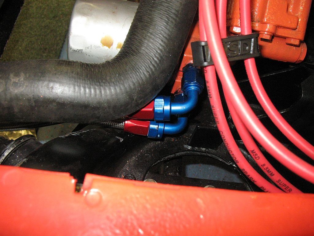

I take it that's a sandwich plate between filter and pump ?
<a href="http://photobucket.com/" target="_blank"><img src="http://i73.photobucket.com/albums/i205/ ... 622f31.jpg" border="0" alt=" photo image_zpsc7622f31.jpg"></a>
Yep.

If your worried about air locks etc turn it through 90 deg so you have one fitting at the top and one at the bottom.
I've had them both ways up on bikes, makes no difference. Any air will get shoved out the cooler very quickly by the pressure!
I've had them silver and matt black, also no measureable difference :thumbright:
