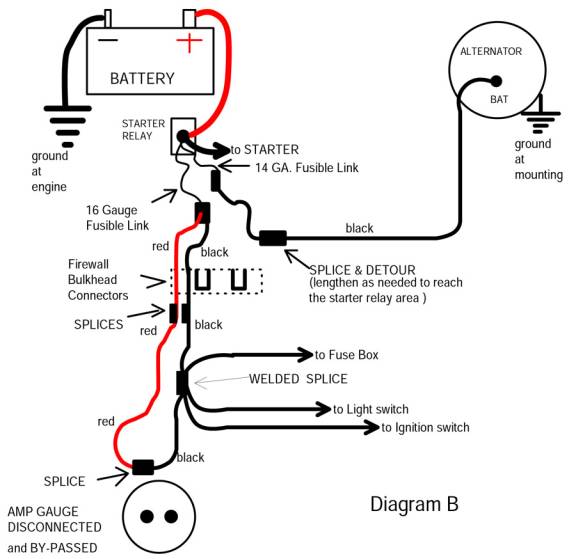

Changed the wiring to get rid of the AMMETER and the fire wall connection for the alternator feed and back to starter.
Followed the wiring and advice, put new cable from alternator to starter relay +, using inline fuse.
Two new cables direct through the connector (took out the connection), linked under dash to black and red cables feeding AMP, linked the black and red cables away from the AMP. These two new cables connected via another fuse to starter relay +.
From starter relay + new cable to battery +
Cable sizes used 6mm & 10mm for direct alternator to battery.
Checked all wiring for continuity and resistance, looks okay (I think).
Battery charged up 13.5V
Started the car reading at battery terminals 12.7V
Rev the engine and no change in voltage 12.7V
Engine off battery reading back up 13.2V

Ok so alternator out put goes to starter and starter to battery yes ?
Then as you know it much the same a skinny post
Forget what you have done with dash and A meter.
Look at reg and other post is it earthed and connected like the picture I posted ? Double triple check all connections

I had the dash out at the time so I got the two cables from the back of the AMMETER and joined them.morgan wrote:I've got a day off today to do this.
I have just spent 2 very uncomfortable hours contorted under the dash with that rats nest of wiring. As usual the problem is access... I cant find the taped/welded splice anywhere. I need it to run the second wire through.
Before I tear the whole damn car apart, where did you find it [roughly] ? I really don't want to de-tape the whole damn loom to find it.
I am really very cross. (came through here to calm down). Why is every 10-minute-job so prone to become impossible ??
Find the two cables going through the firewall and take them out of the connector then follow this
- AMP.jpg (34.26 KiB) Viewed 581 times
Yeah, ta. You have answered my question ' dash out'.
After 3 fruitless hours I gave up and put the ammeter back in.
The problem as always is access. It was this 'madelectrical' diagram I was following (I have all the wire, correct fusible links, shrink wrap, the works - but I cant a) Get to the wires on the ammeter to splice properly and b) find the 'welded splice to properly connect back and bypass connectors.
Its OK. Its always an access prob. It will have to wait until I take the dash out (which frankly I didn't want to do) !
