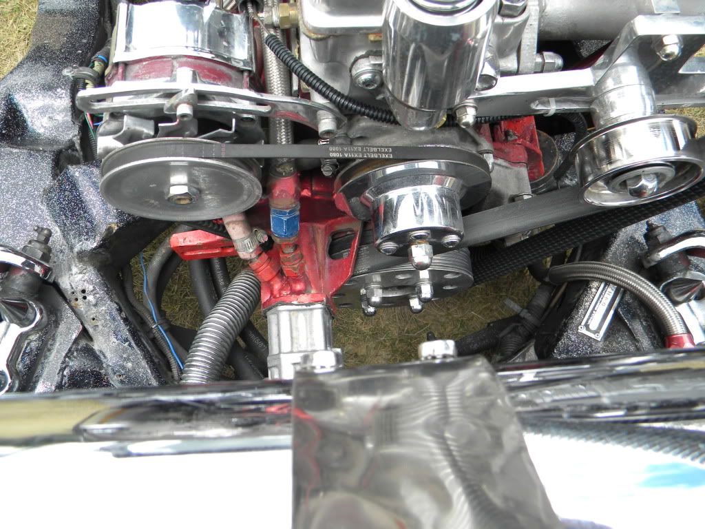

peugeot 406 coupe diesel fans can be had for £20 handy if you want to drive an external oil pump mounted on the timeing cover driven direct from a drive bolted to the end of the cam
like this....no fan space then

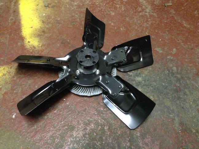

Do yourself a favour and get a mopar performance viscous fan package, job done. The trouble with electric fans on V8's is airflow, you need in the region of 3000cfm, a viscous fan shifts loads more air than most any aftermarket electric fan. You can fit something from a late model car with a V8 that will do the job, but they pull a load of current so you need an alternator with good output or you'll be flattening the battery in traffic. An alternator working hard also robs power. I've tried to go electric in the past and failed, even with a huge ally rad. Ended up with a viscous fan, no shroud and a 22" rad, problem solved, even kept my 511 at 185 degrees in traffic.

I will look into Blue's viscous fan, thanks blue.
