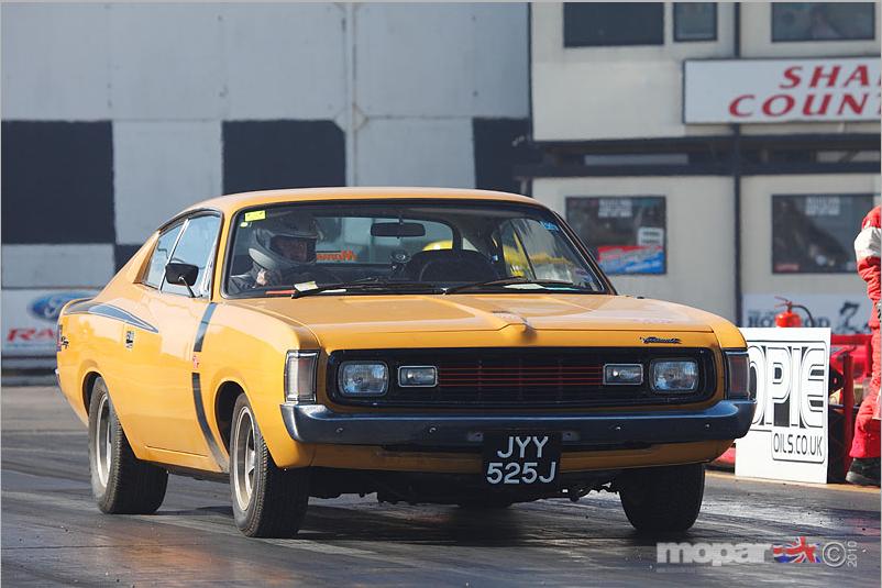

225 70 R14 herculse tyres
http://www.northhantstyres.com/RTS%20final/2257014.html
94 quid + vat
they are about 8-9 inches wide
run 195 transit tyres from your local tyre place on the front. makes the rears look wider
makes steering floaty light
although mine are firestones and only 225 65
this what it look like same A body wheel well
although i must admit i do have a set of 15 inch wheels with Anton at the mo for tig welding and sorting out, cos i too got fed up looking
Hot Rod Drags 2010.JPG (63.91 KiB) Viewed 1799 times
