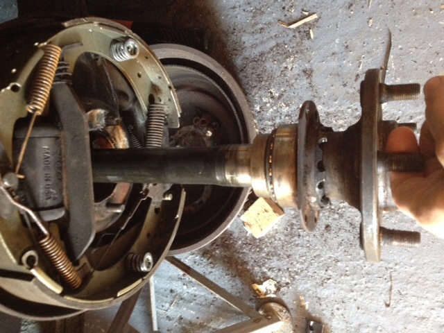

I am currently trying to change the rear wheel bearings on my 1969 Dodge Monaco Coupe - but I'm a bit stumped as to how they come off? I've attached a picture that shows the bearing behind a retaining ring - but this is smooth with no obvious way of detaching it?

or drill it with a bit 3/4 of its width and just deep enough not to hit the axle and do the same
bearing kit comes with a new 1
sacrificial part
you will probably end updoing the same for the bearing inner as well
after you have destroyed the rest of it and sprinkled rollers allover the place trying to take it off
sacrificial part
Getting it back together is a little tricky too, the retaining ring is a shrink fit. You need to get the ring cherry red, drop it on and whack it into position with a piece of long tube. You have to work very quickly because if it cools before you get it into position you're knackered, you won't be able to heat it again on the shaft so it's cut it off and start again with a new bearing.....

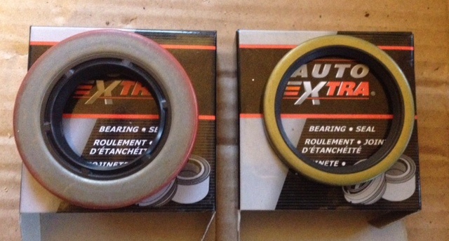

Many thanks - that's a huge help. When I bought the bearings I was also supplied with the two seals pictured but I can't see the old seals on the axel or the half shaft?
Plus the sound from the rear of the car was more of a whiring sound than a grinding noise? Could the seals have been left out by the last owner and
Without them diff has run dry making the whiring / gear noise? or are they under the current bearing and ring set somewhere?
If anyone knows which way round these seals are supposed to go and where please let me know.
Thanks again to everyone who's commented do far on this post.

Dave999 wrote:or drill it with a bit 3/4 of its width and just deep enough not to hit the axle and do the same
sacrificial part
DRILL IT![]()
IT SHOULD ALL BE PRESSED OFF AND PRESSED BACK ON SIMPLE AS THAT,,,,,,
i agree if you have a press.
i know exactly how thick the ring is cos i measured it
set the pillar drill up to go no further ding it with a punch, thin drill fat drill
drilled it and hit it with the chissel at a slight angle, stretched it
ring off
was easier than usuing a cutting disk in the angle grinder
the bearing inner was a pig
no drilling that so the bench grinder came out...
nobody died and i still have both eyes ......
needs must an-all-that
ring off
