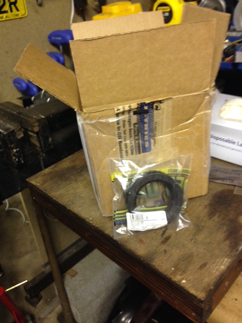

After a lot of argument with Classic Industries about postage costs for a 14 dollar rubber grommet, I finally bit the bullet and paid the 54 Dollars.
This arrived yesterday......
photo 1.JPG (102.06 KiB) Viewed 849 times
