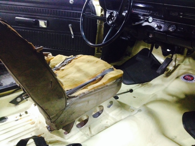

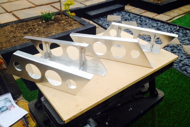

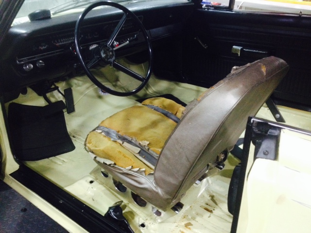

having purchased a pair of `66 A100 seats so I could get rid of the bench its turned into quite a task.
had to special order correct 2 inch pleat covers for em(ouch ££) and have brackets made in ali with some "blue"holes
also a lot of faffing about with the tracks as wanted the drivers side adjustable.

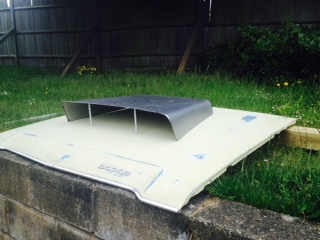

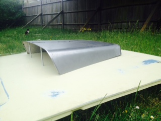

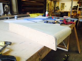

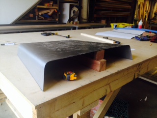

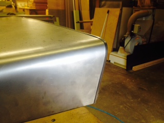

also decided on a 68 hemi style scoop is just what the bonnet needed but could only find fibreglass.
so bought some sheet and went over the joinery shop to make it-hand made over a wooden former after getting approx. dimensions off the web and putting my own interpretation on it.
piccys........
dart seat 3.JPG (135.46 KiB) Viewed 943 times
dart seat 2.JPG (121.29 KiB) Viewed 943 times
dart seat 1.JPG (124.34 KiB) Viewed 943 times

more pics of scoop-apologies if in wrong order........
dart scoop 1.JPG (37.74 KiB) Viewed 934 times
dart scoop 2.JPG (36.29 KiB) Viewed 934 times
dart scoop 3.JPG (31.81 KiB) Viewed 934 times
dart scoop 4.JPG (39.31 KiB) Viewed 934 times

072
Spot on :thumbright:
Very impressive as ever, so it was you Gary was making seat mounts for....
LONGSHOT
Posts: 1009
dart
Post by LONGSHOT »
yes Blue-he is very good(and a nice bloke)-I made a template in wood and gave him a picky off the net and hey presto-done.

Just wondering how you formed the lip at the front of the scoop, and assume you had to cut and weld to form the rear corners?
LONGSHOT
Posts: 1009
scoop
Post by LONGSHOT »
Blue-for the the lip we used a small u channel (bought from metals direct online)
and drilled 1/8 hole on inner lip to keep in place.
the rear was difficult and made another former to bash over and weld on.
I say "we" as I owe credit to my mate for a lot of it .
dave" longshot" long
